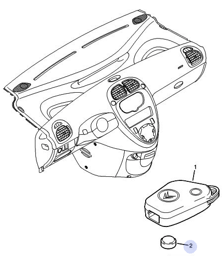

Your version is just before the change to VAN CAN multiplexing. Your remote fob would of looked something like this:
Do you have this type of fob? If not you may have only been passed the other key that looked like this:
Regardless of type, each has a transponder chip incorporated into the fob. The larger fob in the first diagram has the additional circuitry to send the remote locking and unlocking requests to the vehicle.
If you are missing the fob, you can get one ordered from the dealer which will contain a new key blade and remote and they will code it to the vehicle for you.
There are aftermarket suppliers of copies of these fobs, but unless you get the right one you may have issues. Regardless it will need coding to the vehicle using Citroen's software. The part number for your fob is 6490L8 and these are £123.28 inc. VAT from Citroen for the remote fob.

Yes i only have the key in 2nd picture so will look at getting one ordered, thanks for your help today marc
