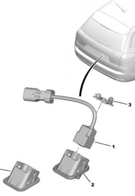

Hmm... Can't see any other hole as you describe Gary:
Does it look like it was made by the previous owner perhaps? The rear reversing camera on later Tourer facelifted models had the camera mounted near the number plate, thus:
Meanwhile, I can look at the wiring for your car for the reversing feed if you pop your VIN up here - (I know you did previously post it, but that was before the system masked it, so it has been permanently hidden as it was manually deleted).

Re: Reverse light connection for dash cam
The actual reversing sensors are located in the lower black bumper skirt Colin, and there are 4 of them, so I'm still puzzled as to what this other 'hole' is.
Just had a look and you are right Marc, i cannot see any "hole" in the bumper or anything above the centre of it and the sensors are located in the lower skirt.
Could the previous owner have had something fitted that has now been removed and used a generic grommit to plug the hole of the same colour ?
Just had a quick look and it’s one of the holes for the reverse sensor as there are another 3 of them. I didn’t notice them. I tried to connect it to the tow control box, this has 2 lots of connectors that do the same thing. One lot are wires and the other side is screw connectors. I tried the reverse on the screw side but no luck. I’ll need to get my voltage gauge out and check the wire side.
