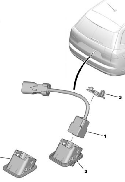

Does it look like it was made by the previous owner perhaps? The rear reversing camera on later Tourer facelifted models had the camera mounted near the number plate, thus:
Meanwhile, I can look at the wiring for your car for the reversing feed if you pop your VIN up here - (I know you did previously post it, but that was before the system masked it, so it has been permanently hidden as it was manually deleted).
