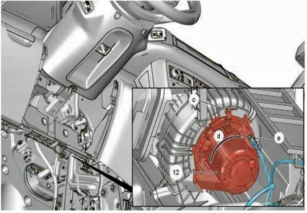

Ignore Steering wheel that's for LHD vehicles, we are blessed with most of this gubbins being on the left hand side!
Disconnect the air blower (12) connector ( as "e").
Press the tongue ( as "c") ; Turn the air blower (12) clockwise to disengage it from its retaining lugs (In the direction of the arrow "d").
Release : The soundproofing under the fascia panel and around the air blower (12).
Remove the air blower (12)

Re: C5 X7 Fan Blower Motor Location
Thanks Marc.
Can you please advise on the orientation of the motor please, it’s a bit difficult to make out from the very good picture.
From the side?
Regards,
Barry
From the side?
Regards,
Barry
Hopefully this puts it in context: the motor itself is pointing towards the left hand side of the car. Those flat square panels are at the top. The parts (1) & (2) above are the motor extracted from the housing.KingB wrote: 18 Dec 2018, 17:25 Thanks Marc.
From the side?
Regards,
Barry
