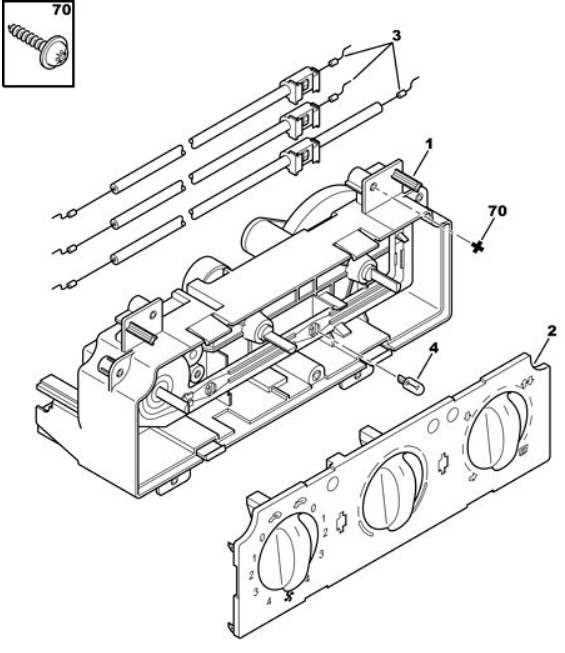

Given what you mentioned about the lighting too, I would be leaning towards an internal fault of the heater control panel.
Taking it apart and giving it a clean up of the contacts may solve the problem - you could also replace the lighting bulb at the same time (shown as 4 in the diagram (1.2W))

Sounds like the track on the speed dial - but costs nothing to try and clean it up in case it is a contact problem.
