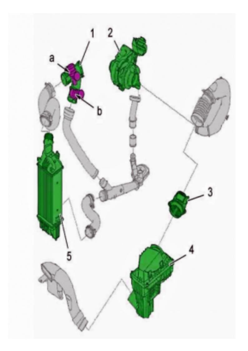

Got the car back this morning, still waiting for the rad to arrive, so can't start it (apart from the 20 metres to get in on the drive). First thing to check is that the 2 air mixers are working, but I can't at the moment because I need to start the engine to give a vacuum. I'm still puzzled as to why the pipe got blown off. I really don't want it to stuff another rad. I counted the screw turns to undo the jube clip and then re-tighten in order to re-fit the pipe, 5 1/2 to undo then 6 to re-tighten? So it would seem as if it was fitted correctly unless it wasn't over the flange properly? If there was enough pressure to force the pipe off I would guess it would have done it before when it had the hiccups?
A question for those with the single butterfly (without B or the bypass pipe). When the doser A closes where does the turbo pressured air go, and does it then just run via the egr? Or does it only partially close?

From my (extensive) research, I can find no evidence that the single air doser (Delphi) ever closes apart from to choke the engine at shutdown.
If I was you I’d remove the little vac pipes from the double air doser and block them. They appear to be the source of a lot of issues on your car.

Very interesting Elis.
That's a lot of manufacturing expense for diddly? I can get my head round the Siemens system because it bypasses the IC to assist regen. So in effect, you could remove the butterfly from the body (or in my case both), leave everything else in place so the car thinks it's doing as it's told, happy ever after...
