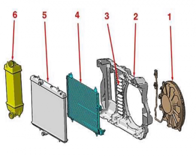

Excellent. I hope it missed the condenser when it hit though Pete ....
- GiveMeABreak
- Posts: 37339
- Location: West Wales
C5 MK I 2.0 HDi SX Wicked Red
C15 Romahome White
XM 2.0 SX Polar White
CX 20 Polar White
GS 1220 Geranium Red
GS 1000 Cedreat Yellow - x 5723
Re: 407 radiator
(1) electric cooling fan unit. (2) Fan assembly cassette panel . (3) Anti-recirculation grille : DW10BTED4 = 2 x 6 ventilation flaps (4) Condenser . (5) Radiator. (6) Fan assembly cassette panel . |
