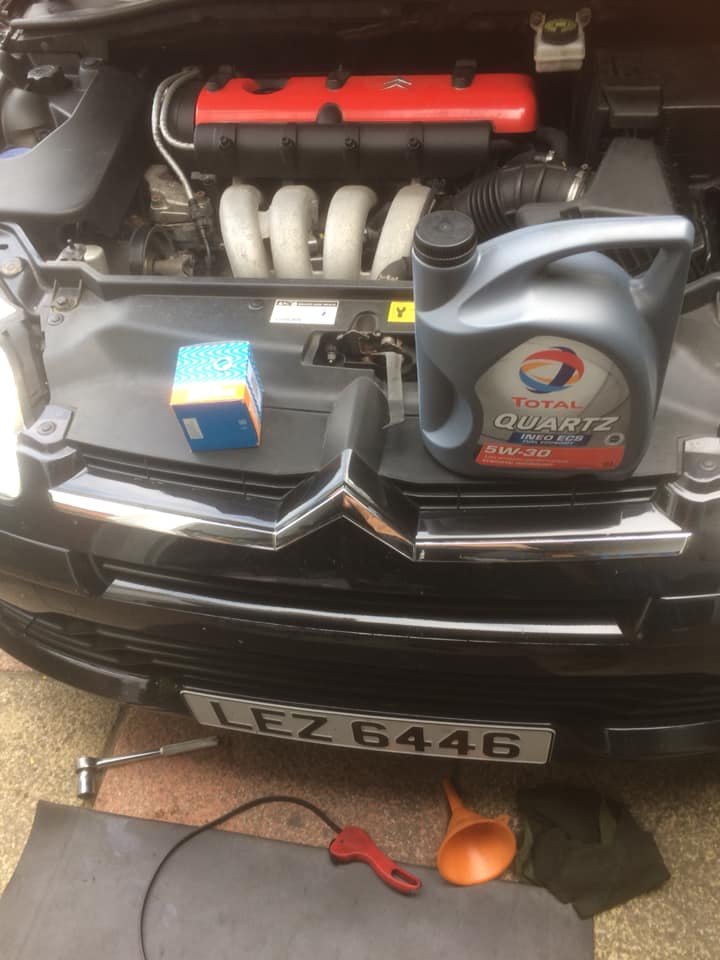

This is what Citroen dealers sell for the VTS 180 in England. I first started using it on my first VTS. On my second VTS I used it until the car was scrapped at 197000 miles. It used almost no oil between changes at 10000 mile intervals.
I have now changed the oil twice on LEZ and again it really didn't use any oil in 12000 miles (I was late changing this time!).

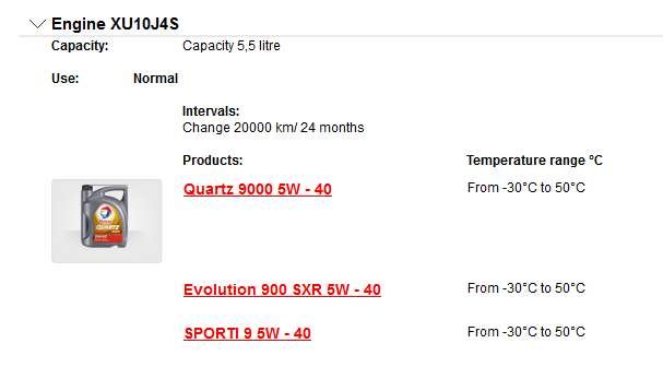

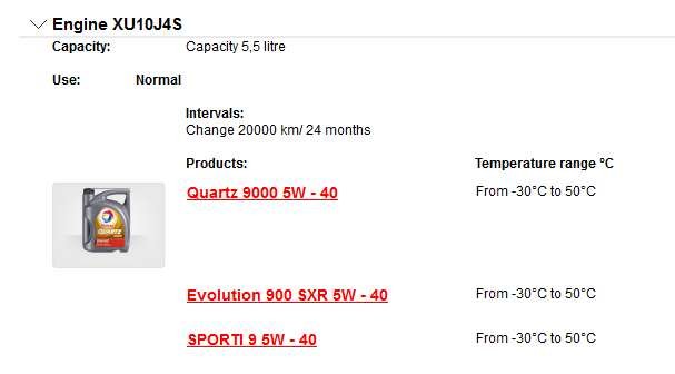

This is what Total recommend for your car / engine......
