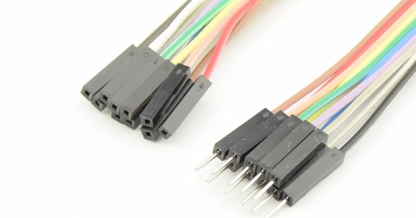

If still lacking the brown (power) conector to the screen, you can use Dupont wires. There is just enough space to plug them on the pins and they sit well in. I did so on my RNEG display retrofit previously...robdevil wrote: ↑05 Feb 2021, 11:36 Hi. I know it is old post but I need help. Where can I get brown plug for DS5 touch screen? I want to retrofit smeg+ IV2 and this is only one thing I don't know how to connect. i do have video cable but touch screen has additional socket and I'm sure it is power socket. Old screen has different power plug so wiring diagram would be useful as well.
Now, there are 4 pins on SMEG+IV2 display. I believe 1 is live (+), 2 is becklight and 3 and 4 are ground (-) as on RT4, 5 and 6 systems (same manufacturer) but that needs checking out!
On the photo is an actual SMEG+IV2 display with two Dupont wires plugged in.
Re: RNEG to RT6 to SMEG+ IV2?
You can connect it without brown connector, simply by using Dupont vires. They sit perfectčy to the pins on the back of the screen and don't fall out.
That's how I done it on RNEG modiffication and those pins are the same.
Here tried on my spare SMEG+IV2 screen (not tested in the car) and it feels the same.
Nowt much to loose if you try that option really as those vires are fairly cheap...

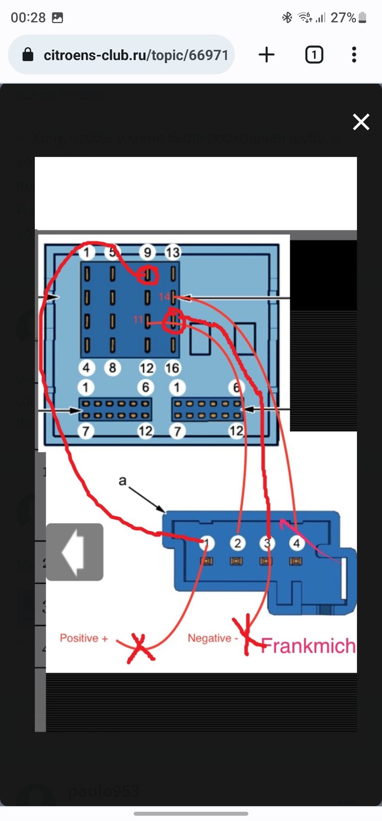

Hi, I am close to installing the SMEG+ as the RT6 replacement, just missing the screen brown connector layout.
To confirm the picture from robdevil above -
Number 1 goes to slot 9 thats clear
Number 2 goes to slot 11
Number 3 goes to slot 15
Number 4 goes to slot 14.
Is that right?
First number is the screen connector, the slot number is the main unit connector.
