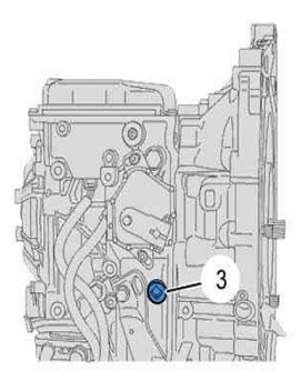

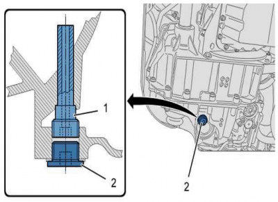

Remove:
  • The top-up plug ( 2)
  • The oil overflow and drainage plug (1)
    (Approx. 3lt of oil should flow out)
Refilling
  • Fit the drain overflow plug (1)Tighten to 0,9 ± 0,2 daN.m.
  • Remove the filler plug (3).
  • Use tool [1].
  • Dry gearbox oil capacity : EW10 engine(5,85 litres).
  • Oil remaining after draining: 3 litres(approx.).
  • Quantity of oil to be replaced: 3 litres(approx.).
  • Refit the filler plug ( 3)(equipped with a new seal)Tighten to 2,4 daN.m.
  • Initialise the used oil counter (follow the diagnostic tool procedure).

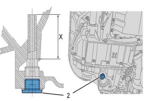

Check the Oil Level
Prior Conditions :
  • Vehicle level
  • Check that the gearbox is not in downgrade mode
  • Add 0,5 additional litres of oil in the gearbox
  • Apply the brakes firmly and move the lever through the various selector positions
  • Gear lever in position "P"
  • Engine running, At idle
  • The oil temperature 60°C (+ 8°; - 2°)
Remove the oil level plug ( 2).
Note: Distance of 'X' for the EW10 Engine is 48mm (which yours is)
Take note of the following conditions:
Stream of oil then reducing to a sequence of drips
Refit the oil level plug (3)(equipped with a new seal)Tighten to 3,3 ± 0,5 daN.m.
Sequence of drips or nothing
  • Refit the oil level plug (2).
  • Stop the engine.
  • Add 0,5 additional litres of oil in the gearbox.
  • Repeat the top-up procedure.
    N.B.: The level of oil is correct when the stream of oil becomes drop by drop.
    Refit the oil level plug ( 2)(equipped with a new seal)Tighten to 3,3 ± 0,5 daN.m.

Refit the filler plug (3)(equipped with a new seal)Tighten to 2,4 daN.m.
