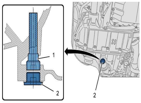

Re: 2005 C5 2,0i 16v Weekend Aut, AT oil chance
This is the drain and refill procedure for you on the AL4 for the C5 MK II:
Notes:
Drain & Refill
Check the Oil Level
Prior Conditions :
Take note of the following conditions:
Stream of oil then reducing to a sequence of drips
Refit the oil level plug (3)(equipped with a new seal)Tighten to 3,3 ± 0,5 daN.m.
Sequence of drips or nothing
Refit the filler plug (3)(equipped with a new seal)Tighten to 2,4 daN.m.
Too high a fluid level can cause:
Notes:
- The gearbox must be drained when the oil is hot (60 °C minimum), to eliminate the impurities suspended in the oil.
- The oil change is partial, since the converter cannot be totally drained.
Topping up Cylinder Tool (-) 0341. |
Remove:
| Refilling
Prior Conditions :
- Vehicle level
- Check that the gearbox is not in downgrade mode
- Remove the filler plug (3)
- Add 0,5 additional litres of oil in the gearbox
- Apply the brakes firmly and move the lever through the various selector positions
- Gear lever in position "P"
- Engine running, At idle
- The oil temperature 60°C (+ 8°; - 2°)
Remove the oil level plug ( 2). Note: Distance of 'X' for the EW10 Engine is 48mm (which yours is) |
- Refit the oil level plug (2).
- Stop the engine.
- Add 0,5 additional litres of oil in the gearbox.
- Repeat the top-up procedure.
N.B.: The level of oil is correct when the stream of oil becomes drop by drop.
Refit the oil level plug ( 2)(equipped with a new seal)Tighten to 3,3 ± 0,5 daN.m.
- Overheating of the fluid
- Fluid leaks
