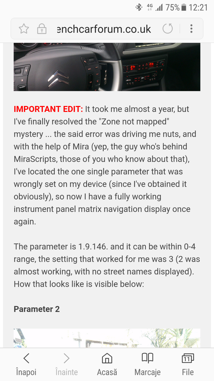

Re: GPS antenna
By the way, how can I found this parameter?!?
On Diagbox it has names, but not numbers So I couldn't find it...

Re: GPS antenna
That is only to configure the dashboard multifunction screen fo a non-factory fitted option to display navigation instructions. You shouldn’t change anything there for a factory fitted system or you could find you will have no data when you get the unit fixed.
Vborovic was changing from a vehicle with no previous navigation system, so needed to configure his dash correctly.
