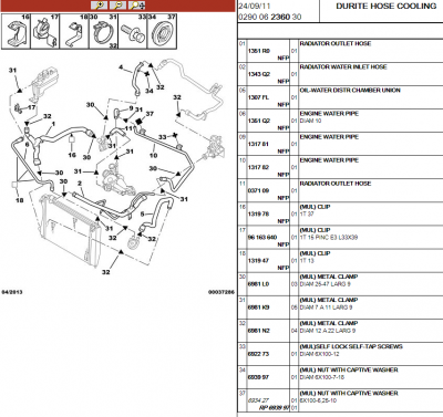

Afternoon Cam
, what's your VIN please and I'll put up the diagram and part Numbers for you.

Here you go - as expected none of these are available from Citroen, but at least you can identify the part numbers for alternative suppliers:

Click Image to Zoom
Best of luck with getting the parts though.
