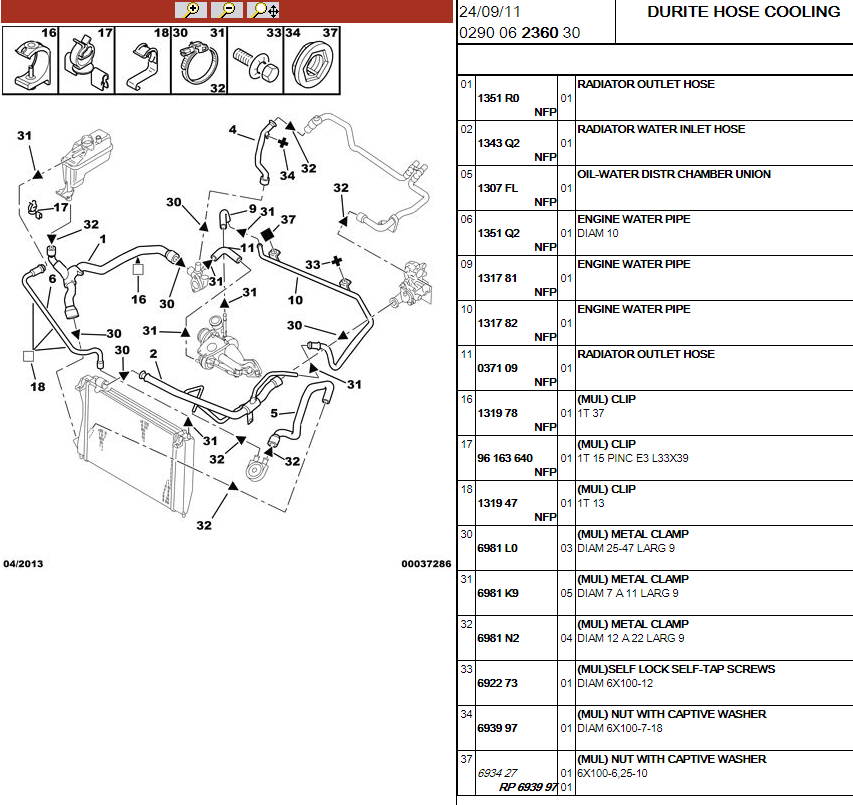

Afternoon Cam :-D , what's your VIN please and I'll put up the diagram and part Numbers for you.

Here you go. Thanks a lot
VF7**************[VIN obfuscated, can be read by forum staff]*******
x 6950
Re: Xantia CT Top Rad hose needed!
Here you go - as expected none of these are available from Citroen, but at least you can identify the part numbers for alternative suppliers:
Are you the same Cam85 on Aussie Frogs? I've just been reading a few posts about your Xantia if you are!
Click Image to Zoom
Best of luck with getting the parts though. :-D

Thanks for that. Ill have a look around with those numbers.
