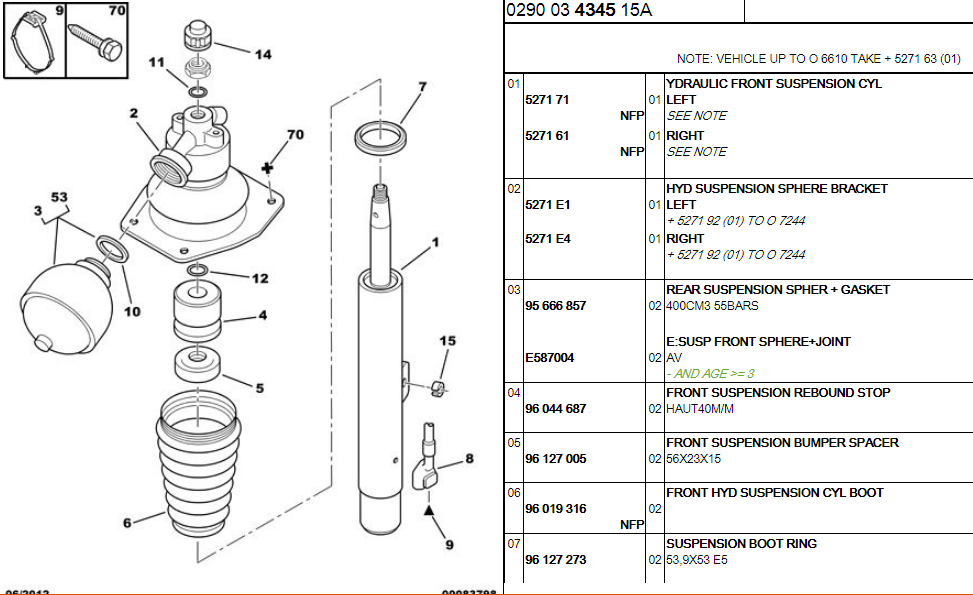

For your car the correct parts for the sphere brackets are as per the diagram:
Strut Support Bracket 5271 E1 Left £234.86 Inc. VAT
Strut Support Bracket 5271 E4 Right £234.86 Inc. VAT
The above are still available from Citroen, although the struts themselves are not.

Re: Xantia parts number suspension strut mounts
No worries - some of the parts are no longer available (indicated as NFP), but you may be able to source alternatives - using the part numbers shown. Best of luck.
If it's part (2) - the sphere bracket, they show as available and are priced at £234.86 inc. VAT each in the UK from Citroen, Graeme.
The simple answer is that there are a stack of these with different part numbers, depending on build date and engine / Hydractive / ARCS / and a lot of them are no longer available from Citroen - so would need a VIN to confirm the exact part number for availability Graeme.
