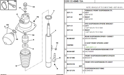

For your car the correct parts for the sphere brackets are as per the diagram:
Strut Support Bracket 5271 E1 Left £234.86 Inc. VAT
Strut Support Bracket 5271 E4 Right £234.86 Inc. VAT
The above are still available from Citroen, although the struts themselves are not.

Wow! Thank you Marc!
Very quick reply and your confirmation of the parts numbers gives me confidence!
- x 6945
Re: Xantia parts number suspension strut mounts
No worries - some of the parts are no longer available (indicated as NFP), but you may be able to source alternatives - using the part numbers shown. Best of luck.

If it's part (2) - the sphere bracket, they show as available and are priced at £234.86 inc. VAT each in the UK from Citroen, Graeme.
