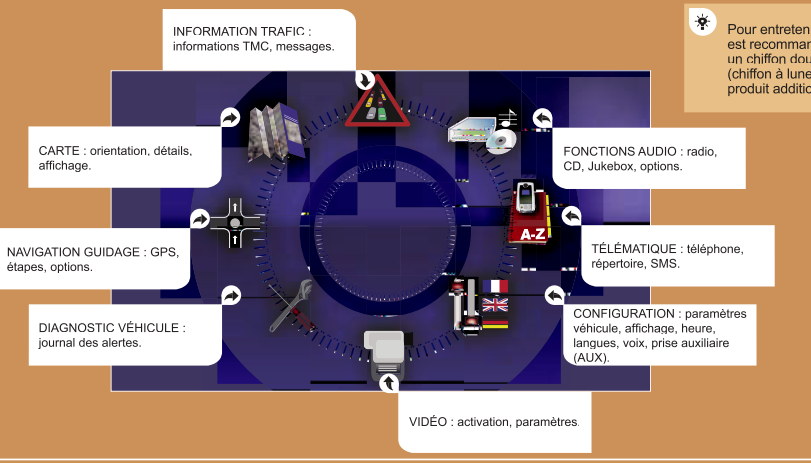

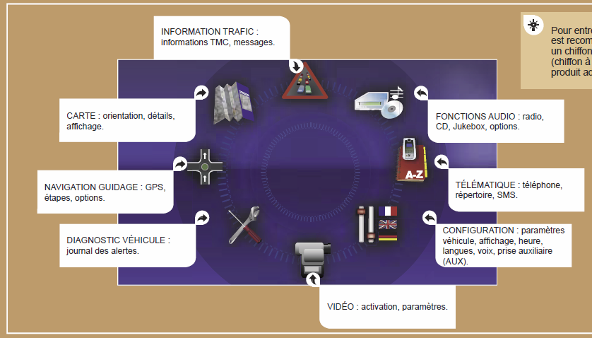

I didn't say that something is not working, but that in the navigation menu (second picture) I think that "a/c" and "vehicle parameters" are missing among other options (navigation, map, telematics, config etc.) I saw some C5s with same hud having the option to choose between compass, analogue clock and a/c information on the left side of the main navigation screen when, for example, playing radio or cd.
- x 6958
Re: Peugeot RT4/5 Update Problem
Right, that makes a little more sense now you have explained it in a bit more detail.
No, those are not official displays for this system. Some of those settings were available on the earlier RT3 Navidrive systems on the MK II C5
As you can see from the manual in the picture below, you have exactly the same display menu - with one exception, the Video menu at the bottom is not available on your screenshot. That normally means either you don't have the video input or it is not enabled (that's another reason why I wanted your VIN).
What you are seeing on those youtube videos or other sites are people who have modified the configuration files, intended for other systems.

Thanks for the reply. Are you 100% sure that RT4 should have both "vehicle diagnostic" and "climate control options" because in a user manual that came with the car there's no such options? If so, please send me correct settings, because I'll ask a mechanic to use his Lexia to check this. The other thing is that I don't want my menu to look like friend's since his climate control is not working correctly - on the left side of the screen (where I have a compass) he has a climate figure (something that looks like a car seat) but when he changes the temperature or air flow position, nothing happens on the screen. There's no temperature value or anything else, on the spot where temperature should be shown, he has only two horizontal lines.
- x 6958
You have to remember that the RT4 was also available on other models and so for those systems that are different to the C5 they may have their diagnostic fault log and climate control temperature settings displayed via the screen. On the C5 X7, by default, the diagnostic fault journal is displayed on the instrument panel LCD screen and activated by a press on the 'CHECK' button on the right hand side of the dash.
To give you an example, this is from the RT4 manual from another older vehicle, where you can see the options I mentioned. But these are not intended for the C5 X7 as the temperature and climate is designed to be displayed on the A/C control panel and as I said the fault logs on the dash screen. The Head units are used across a range of Peugeot / Citroen vehicles and have to be able to work with the different systems. There is nothing wrong with your display - that is how it is designed.
Now the RT systems can be manipulated to display other information unofficially, using a programme called Mirascripts. This is able to enable some options - but they are not officially supported and I can't go into that here.
I suggest you leave the unit as it is - there is nothing wrong with it.

That's what I was wondering. I was able to find only one x7 with the same system as in mine, and since he had such options I thought my system is faulty. But now, I'm thinking that someone used mirascripts in friend's car since climate control option is of no use, and in diagnostic option you can only check which options are turned on or off, nothing else (e.g. child safety, parking sensors, lane assistance...)
This is what a user manual shows for my car. No climate or diagnostics options available:
- x 6958
Yes, those options are activated by dedicated buttons on the X7. An example on the MK II C5 I had with the RT3 Navidrive system - here most of the diagnostic functions and settings / options activation status was displayed on the screen as it didn't have another display menu. On the X7, these functions are handled by the separate dashboard LCD menu when configuring using the steering wheel controls menu for Driver's welcome function, Directional Lighting, DRLs, Auto Handbrake, timed headlamp off settings etc...

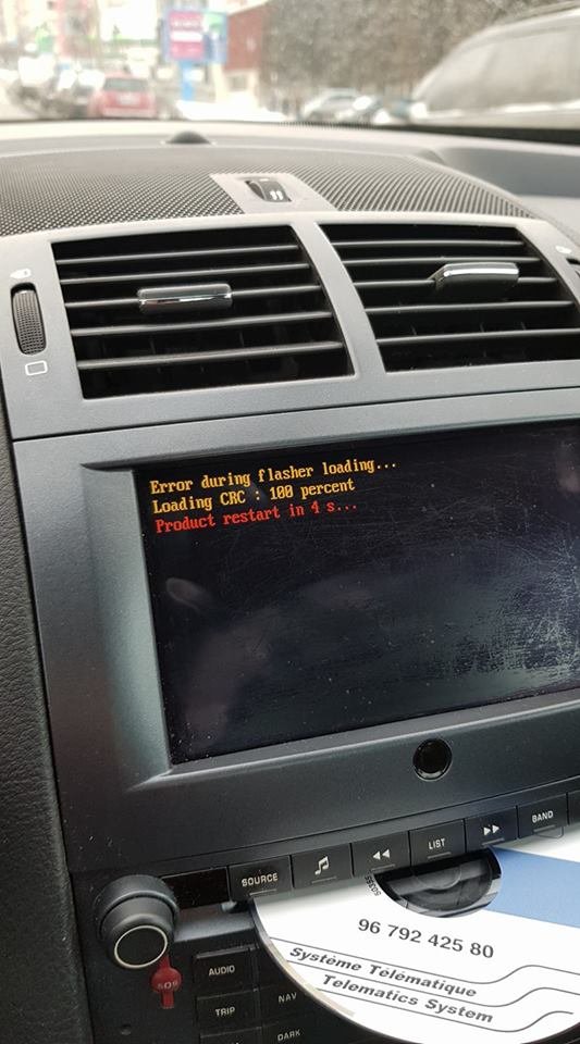

I ve updated the system from a new genuine 8.31 Peugeot CD....now the system does not function anymore. It asks for the Update CD and the process begins again
The error is : Error during flasher loading. The update was done with engine running ...no issues when it was in progress.
What do I have to do now ?!
It s a RT4 407 coupe , earlier version 7.01

Ok, can you confirm if this is an ORIGINAL CD or a copy of the Dealer Firmware CD? It is my understanding that there is a security file that causes problems if making a copy of the original file - which will cause problems.
If you are 100% sure it is an original firmware CD, then you will probably find it is because of the problems between the major firmware updates and some incompatibility issues going from your version directly to 8.31. Many others go in smaller stages.
There is one possibility you can try - Carefully remove the unit. Make sure the upgrade CD is loaded. On the underneath of the unit, there should be 2 very small, white plastic switches hidden down one side of the casing. If you hold these in TOGETHER, with the CD loaded and the car running, it should go into 'Bootloader' Mode. This may work for you.
