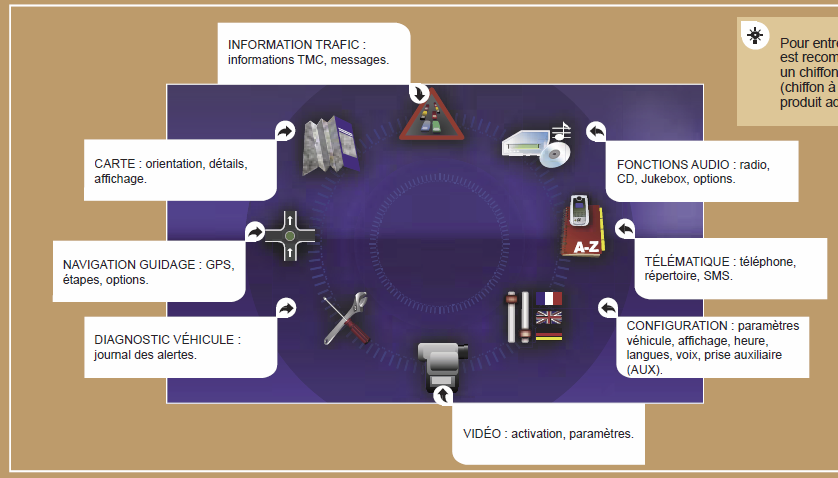

No, those are not official displays for this system. Some of those settings were available on the earlier RT3 Navidrive systems on the MK II C5
As you can see from the manual in the picture below, you have exactly the same display menu - with one exception, the Video menu at the bottom is not available on your screenshot. That normally means either you don't have the video input or it is not enabled (that's another reason why I wanted your VIN).
What you are seeing on those youtube videos or other sites are people who have modified the configuration files, intended for other systems.

You have to remember that the RT4 was also available on other models and so for those systems that are different to the C5 they may have their diagnostic fault log and climate control temperature settings displayed via the screen. On the C5 X7, by default, the diagnostic fault journal is displayed on the instrument panel LCD screen and activated by a press on the 'CHECK' button on the right hand side of the dash.
To give you an example, this is from the RT4 manual from another older vehicle, where you can see the options I mentioned. But these are not intended for the C5 X7 as the temperature and climate is designed to be displayed on the A/C control panel and as I said the fault logs on the dash screen. The Head units are used across a range of Peugeot / Citroen vehicles and have to be able to work with the different systems. There is nothing wrong with your display - that is how it is designed.
Now the RT systems can be manipulated to display other information unofficially, using a programme called Mirascripts. This is able to enable some options - but they are not officially supported and I can't go into that here.
I suggest you leave the unit as it is - there is nothing wrong with it.

That's what I was wondering. I was able to find only one x7 with the same system as in mine, and since he had such options I thought my system is faulty. But now, I'm thinking that someone used mirascripts in friend's car since climate control option is of no use, and in diagnostic option you can only check which options are turned on or off, nothing else (e.g. child safety, parking sensors, lane assistance...)
This is what a user manual shows for my car. No climate or diagnostics options available:

Yes, those options are activated by dedicated buttons on the X7. An example on the MK II C5 I had with the RT3 Navidrive system - here most of the diagnostic functions and settings / options activation status was displayed on the screen as it didn't have another display menu. On the X7, these functions are handled by the separate dashboard LCD menu when configuring using the steering wheel controls menu for Driver's welcome function, Directional Lighting, DRLs, Auto Handbrake, timed headlamp off settings etc...
