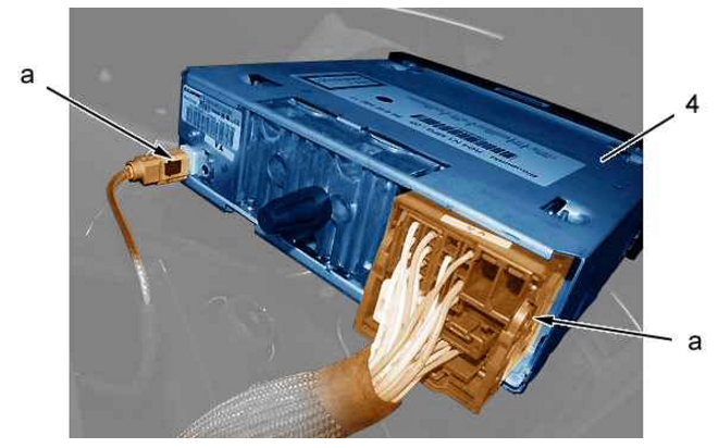

As for the adaptor, you'll need one to convert the Fakra connector at (a) below to the aerial on the aftermarket unit. You will also need to find a permanent live for the harness I suspect.

- Reconnect the vehicle battery, wait a further 2 minutes (do not open doors).
- Switch on the side lights through the driver's window.
- Switch on the ignition and check system's functionality.
- Hold lock button on key down for 10 seconds.
- Remove key open & close door test central locking system.
- Start the engine and complete the system's check.
