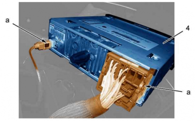

Ok, so you have the RD3 system without CD changer option.
The lines with dashes are for optional equipment like Auto PC - Navigation - Telephone etc., so can be ignored.
Note: the radio is controlled by the BSI using the VAN Comfort network, including the display lighting, VIN code and vehicle Speed information (for speed sensitve volume). If pressing the Power / Volume knob (D1 on the diagram below) on the unit does not switch it on, check fuse 20 in the passenger glovebox. If that fuse is fine, then only a diagnostic using Diagbox / Lexia will be able to determine any fault codes / perform any tests.
Click to Zoom There should be an /8 pin black connector that utilises 6 wires (6 pins active):
9004: Comfort Van data bus
9005: Comfort Van data bus B
XFA: (Unknown) - but does go to Fuse number F20 in the passenger compartment glovebox - so assume this is the power to the unit.
8410: Left-hand front loudspeaker + command
8515: / Voice synthesis / info (probably from the Traffic master Unit)
8454: Ampli + switch command (for the aerial)
M8410: EARTH
The wires in the 8 Pin White block are:
8470: Right-hand rear loudspeaker + command
8471: Right-hand rear loudspeaker - command
8430: Right-hand front loudspeaker + command
8431: Right-hand front loudspeaker - command

20 Pin Multicoloured Connector but probably on 3 of these are utilised for this car:
8516: / Voice synthesis / info
Click to Zoom Note the above will likely be incorporated into the Quad lock block.

As for the adaptor, you'll need one to convert the Fakra connector at (a) below to the aerial on the aftermarket unit. You will also need to find a permanent live for the harness I suspect.
If you wanted to keep the original unit, you can try hooking it up to Lexia and see what issues there are with the screen ECU - the radio may be fine.
As you mentioned about the display showing nothing - does it show any other information? Suspension height change info, trip info, etc.? There should be a vertical rectangular button each side of the multifunction display screen - pressing the left hand one for a long press should access the configuration adjustments and the right one should scroll through the choices.

Spurious wrote: ↑07 Jan 2018, 12:39GiveMeABreak wrote: ↑07 Jan 2018, 11:57 There is also one another thing to consider - the RD3 radio unit on the MK I is controlled by the multifunction screen (I think you have type A) - which is essentially an ECU. If there is an issue with the unit then it may be affecting radio operation as it is this that can switch the unit on or off.
Yep the multifunction display works okay. Warning messages like Ice and Open Doors work. MPG/Av. MPH/DTE seem to work okay too. I was able to set the clock and configure the units on it. Suspension height comes up too.
There is one other thing I only thought of. I guess the dealer had the battery out for some reason as the time and date were near the default. I know the ECU is quite fussy about how the battery is disconnected. I learnt this the hard way a few years back through ignorance, I'd a C5 that needed to have the software flashed onto the ECU after I didn't disconnect the battery the right way. It unpaired the keys that time.
Would it be worth going through a BSI reset, following this (https://www.frenchcarforum.co.uk/forum/ ... 11&t=40407)?
