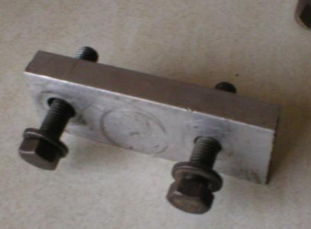

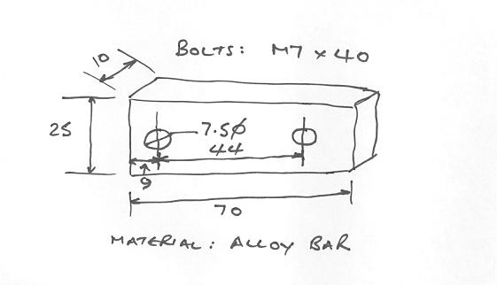

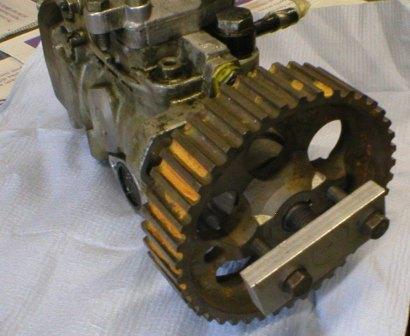

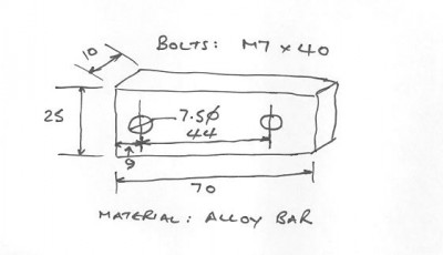

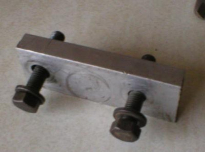

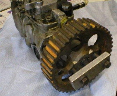

Here they are...
The design:
What it looks like:
How to use it. (Engine removed for clarity) Works on both Lucas and Bosch pumps...
The bolts are M7... An odd size but you can 'borrow' a couple from the gearbox housing

Re: Diesel Pump
And leave the nut on the pump (unscrewed a few turns) to look after the thread and it stops the whole lot leaping off uncontrollably. Then you can remove the pulley and woodruff key easily without visiting the land of pain

Re: Diesel Pump
moizeau wrote: 04 Dec 2017, 19:18Then you can remove the pulley and woodruff key easily without visiting the land of pain
But no, you leave the pulley (sprocket) in place so that there is no need to disturb the cambelt
The puller is gentle enough to not cause any damage to the driveshaft threads...
Neil, on thing I forgot... Before you start, mark the position of the pump on it's cradle with a line across the pump flange to ensure that on reassembly the pump static timing is maintained...
