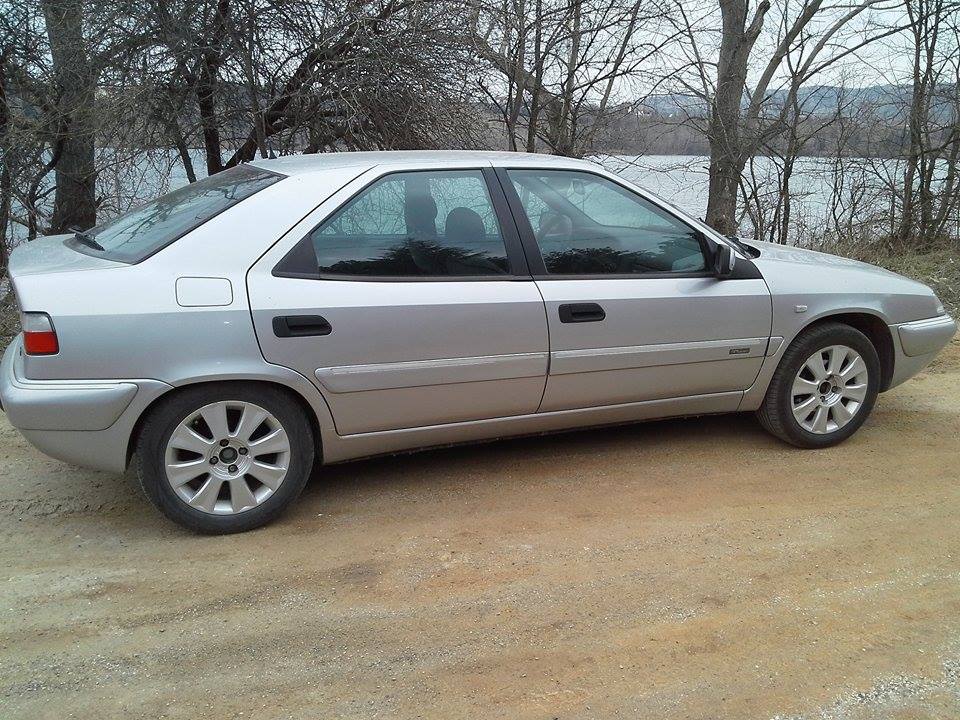

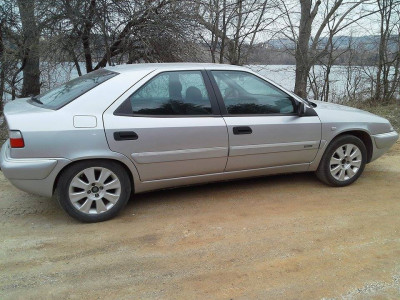

I found a used cap from a scraped xantia. Hope i will get it replaced on Monday.
This is my Xantia
This is my Xantia

Excellent! Your Xantia looks absolutely lovely Dusan
A Xantia is one of the very few cars that look good in silver...
