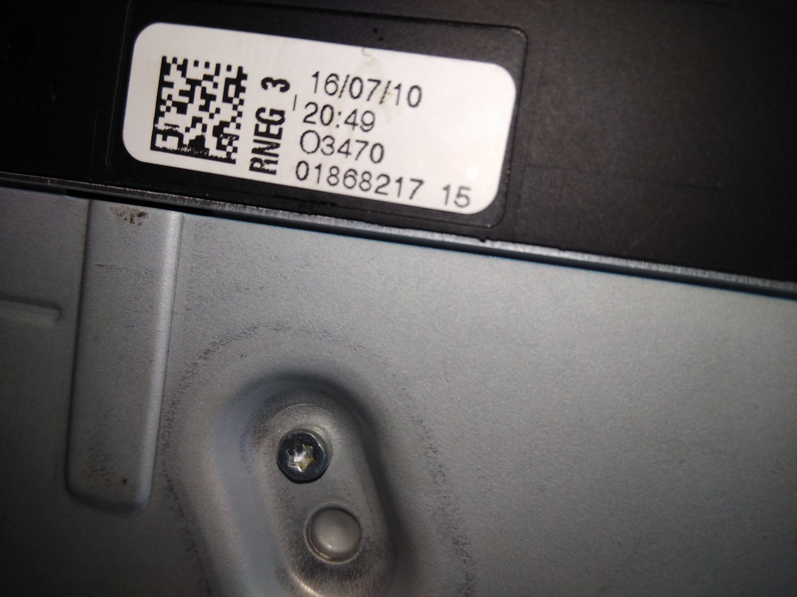

Hi I wonder if someone can help. I replaced my rneg 3 head unit which died with an rneg 12 unit. Got most things work except... On the new unit there is no central dial. I can't select options on menus. I've tried with the right hand scroll wheel on steering column but that doesn't respond. I have access to lexia.

No such thing as RNEG 3 & 12...
Without properly understanding what original AND replacement Head Units you are referring to I can't help. What is your VIN so I can determine what you had and we can go from there. Coding everything and checking compatibility is essential.

Thanks for the reply. My vin is VF7**************[VIN obfuscated, can be read by forum staff]. It might be of help if I could send photos of the units to give you a clearer idea of what I'm on about.

GiveMeABreak wrote: 09 Nov 2017, 14:02 No such thing as RNEG 3 & 12...
Original
Original
Original
Original
Replacement
Replacement
Toncar1

Top and bottom pic are from the original head unit. The middle pic is the replacement.

Ok, can you show me the front of the new unit please? I suspect you are trying to replace an RNEG (MyWay) with and RT6 (eMyWay or RNEG2) system. This will help confirm.
