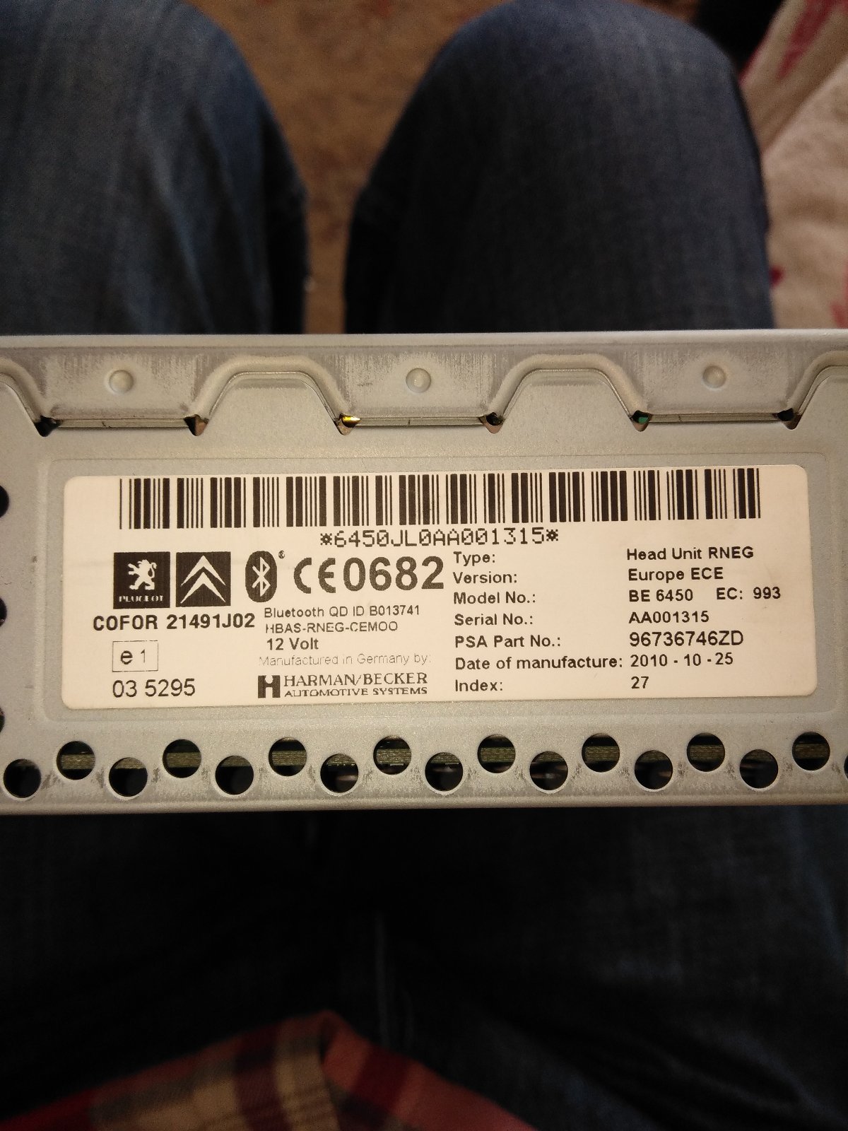

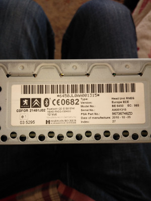

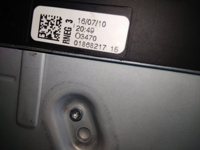

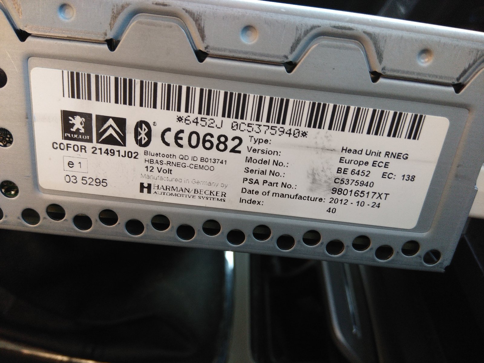

Hi I wonder if someone can help. I replaced my rneg 3 head unit which died with an rneg 12 unit. Got most things work except... On the new unit there is no central dial. I can't select options on menus. I've tried with the right hand scroll wheel on steering column but that doesn't respond. I have access to lexia.
- x 6962
Re: C5 X7 2-in-1 navigation tutorial
No such thing as RNEG 3 & 12...
Without properly understanding what original AND replacement Head Units you are referring to I can't help. What is your VIN so I can determine what you had and we can go from there. Coding everything and checking compatibility is essential.
Thanks for the reply. My vin is VF7**************[VIN obfuscated, can be read by forum staff]. It might be of help if I could send photos of the units to give you a clearer idea of what I'm on about.
Top and bottom pic are from the original head unit. The middle pic is the replacement.
Thanks
Thanks
- x 6962
Ok, can you show me the front of the new unit please? I suspect you are trying to replace an RNEG (MyWay) with and RT6 (eMyWay or RNEG2) system. This will help confirm.
