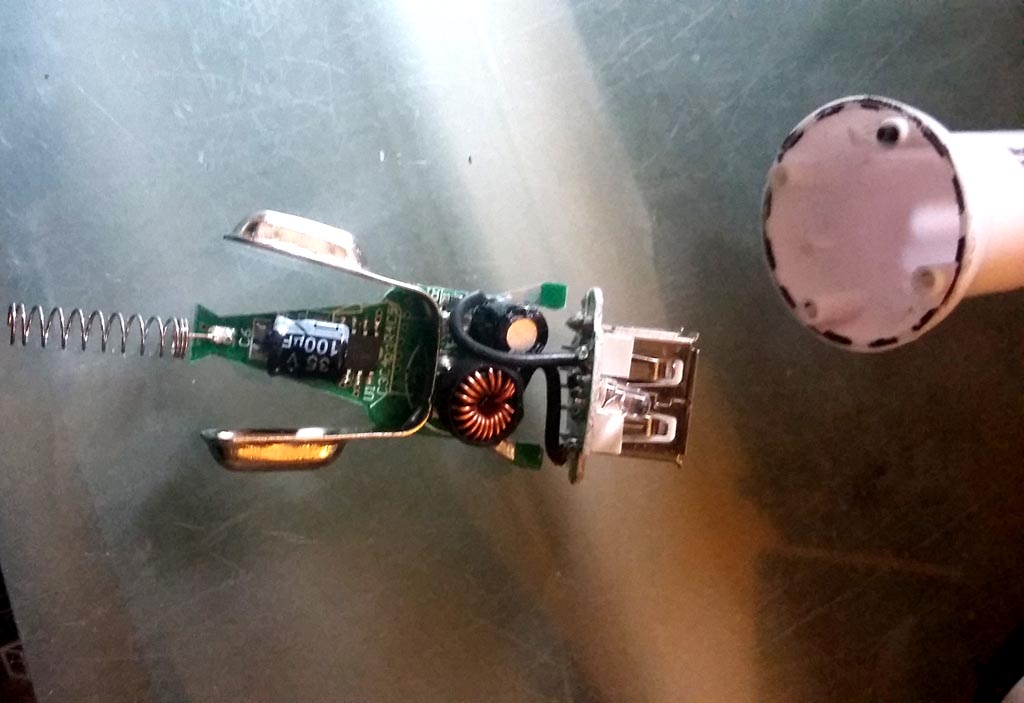

This is reportedly a good one......it emits (as do all my others) massive interference
How would you install shielding to this.....as I am sick of paying for these
RF Shielding......in-car power supply

Wrap it with insulating tape and then copper sheet.

Take a couple of turns of the output cable round a ferrite ring as near as possible to the supply. Most of the radiation is probably from the cable.
If that doesn't help, build your own using a 5V regulator and a couple of capacitors.

But shouldn't the output already be shielded? All my usbs are.
Has your car had a heater matrix alasdair? You seem to have more peoblems with this than others. I wonder if your fag lighter supply has been put back next to radio cables.

Full 12 volt Power out is to a Multi Port Block
Ferrite ring already installed.....does not make any difference
Output is OK from the sat nav charger (TomTom)....no radio (reception) interference .....so it is NOT the main 12v fag supply causing the problem.
No noise from the car, no radio (reception) interference or noise from alternator etc when no bullet chargers installed (using for phone and dash-cam)
As soon as I plug in any (I now have 5 of the fracking things) these bullet chargers I get radio "hiss/crackle" as they interfere with radio reception (Both C5 and Xantia suffer) which is very weak in my area.

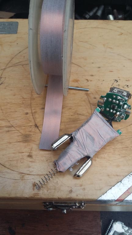

Re: RF Shielding......in-car power supply
No more radio interfearance !
This seems to of worked.......
masking tape to isolate then Copper filled PTF tape (great stuff btw)
