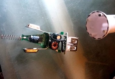

This is reportedly a good one......it emits (as do all my others) massive interference
How would you install shielding to this.....as I am sick of paying for these
RF Shielding......in-car power supply

Re: RF Shielding......in-car power supply
Full 12 volt Power out is to a Multi Port Block
Ferrite ring already installed.....does not make any difference
Output is OK from the sat nav charger (TomTom)....no radio (reception) interference .....so it is NOT the main 12v fag supply causing the problem.
No noise from the car, no radio (reception) interference or noise from alternator etc when no bullet chargers installed (using for phone and dash-cam)
As soon as I plug in any (I now have 5 of the fracking things) these bullet chargers I get radio "hiss/crackle" as they interfere with radio reception (Both C5 and Xantia suffer) which is very weak in my area.

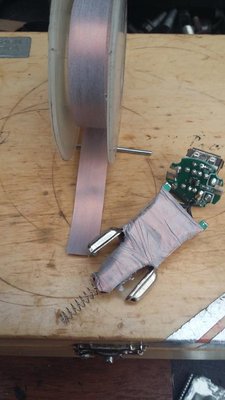

No more radio interfearance !
masking tape to isolate then Copper filled PTF tape (great stuff btw)
This seems to of worked.......masking tape to isolate then Copper filled PTF tape (great stuff btw)
