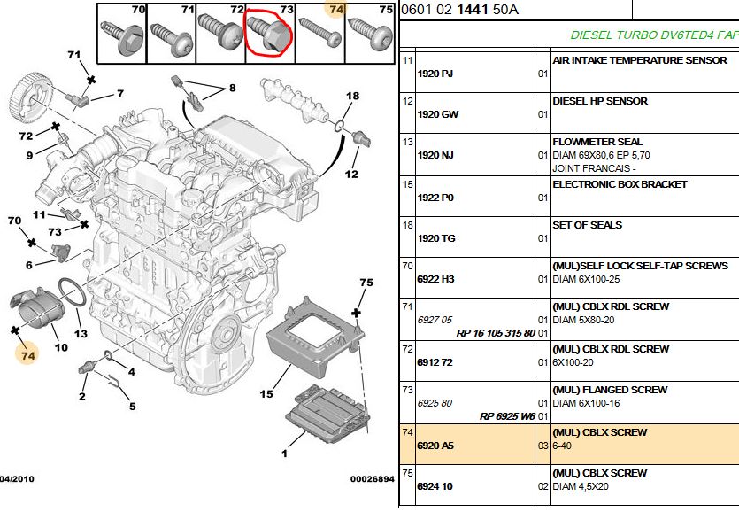

Popped into Citroen's to see if I could get the missing sundries - they don't sell the rubber grommets, only a replacement brackets with pre-fitted grommets for £12.63+dreaded. Also, the MAF bolts (of which three secure the MAF) are sold at £2.45ea+dreaded in a pack of four!
Off to the bay of E for grommets (1422A3). Anyone got part number for MAF bolts, I can't find it on Service.Citroen (what section is it?).
ETA - scratch that, found it. They call it the Inj Calculator Sensor. Also, it states the fasteners are screws (no73) whereas mine has bolts and looks suspiciously like no74.
