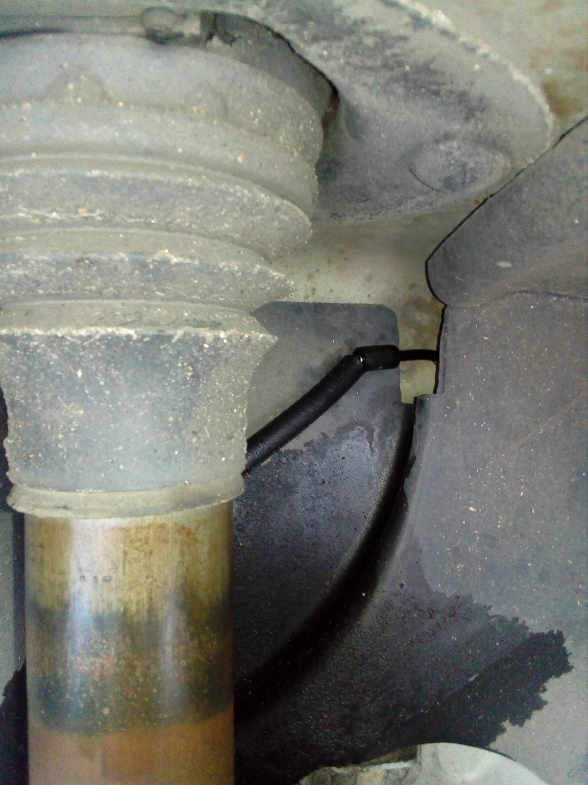

While waiting for the new leak off pipe, I set about bodging a repair so I can still use the car. Was initially going to try amalgamating tape and, once set, wrap that in duck tape for re-inforcement but as I tugged it off the spigot it completely broke away (almost like a clean straight cut). Fortunately, it was just the last 1/2 inch and there's enough surplus length to slip it back on the spigot. Just need to be mindful when setting the suspension to high. This is it before the bodge. I'm concerned because the pipe is in very good condition yet appears to be almost cleanly cut through.
