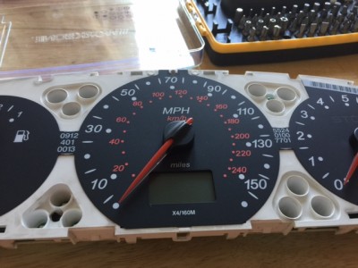

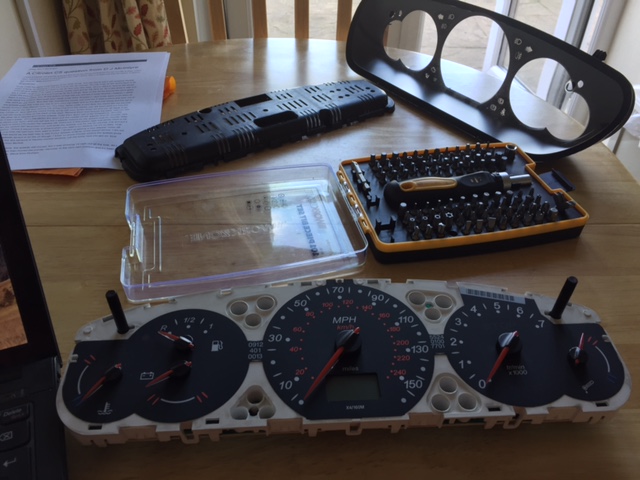

I'd leave it alone, they're a devil of a job to get right and pretty delicate, you could finish up in worse bother.Trainman wrote:following on from Gibbo's point yesterday, the pointer is here:
which does lead me to believe the pointer is out, now for the strip down..............

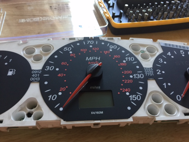

done, but how right it is, only a road test will tell.......... on a side note, I thought I had a couple of bulbs out in the dash, turns out they're LED's
Just taken it for a run, at 60mph on the speedo, the app show 58mph so I'll leave it at that.

Nice work, as I said they can be tricky to get right, shame about the leds but I'm sure you could pop them out and solder in some replacements.

The unanswered question of course, is how did the needle end up so far out of position ?

Knowing how the needle is keyed onto the stepper motor shaft may offer a clue...Mandrake wrote:The unanswered question of course, is how did the needle end up so far out of position ?
My money is on the stepper motor having been changed at some point in the past and no care was taken to ensure the needle was correctly placed...

I did contemplate swapping the stepper motors over, but decided against it. I did wonder if they had been swapped over before.......

IIRc it's just pushed on to a taper so no key.CitroJim wrote:Knowing how the needle is keyed onto the stepper motor shaft may offer a clue...Mandrake wrote:The unanswered question of course, is how did the needle end up so far out of position ?

That would make sense as it would park without obscuring the lcd display.

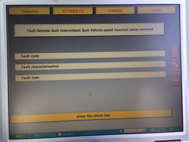

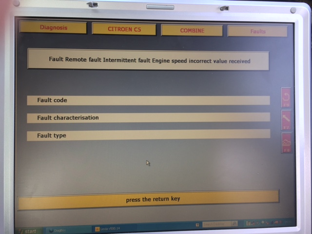

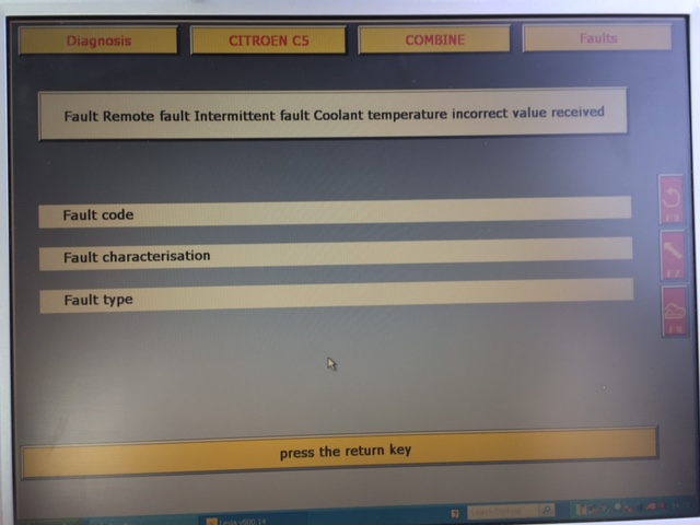

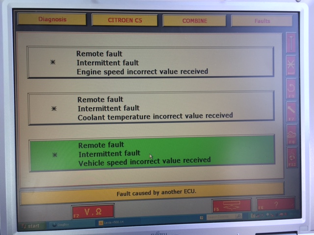

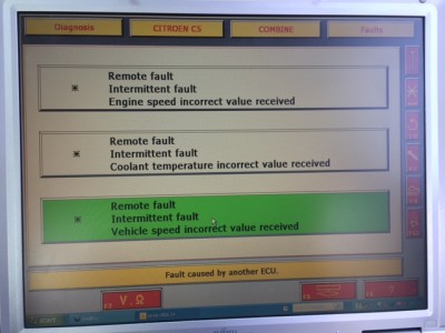

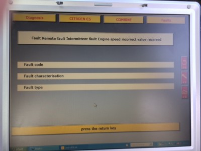

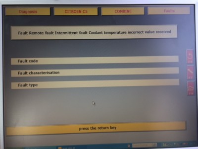

Managed to get Lexia on the car today, (Dozy hole, here forgot I'd installed version 5.02 to an old XP laptop I had in the loft)
I've got 3 faults, so I'll have a look at these over the next couple of days:
For a 15 year old car, I'll settle for these.........
Steve
http://c6owners.org/index.php
- Posts: 14306
- x 3306
Re: It's been a while (C5 Adventure)
Steve, I believe that those may be 'phantom' faults. I wish I could remember who (on this forum) mentioned them, but I did, quite some time back, find I had those same three faults on my C5, and the codes matched the Citroen C5 phantom faults.
