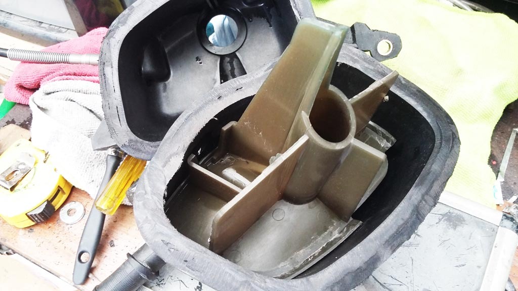

Unread post by Stickyfinger »
Inside a V6 expansion tank:

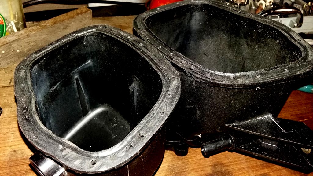

Attempting a repair......................groves cut for a gasket material/adhesive.
Holes drilled for rivets, this will not be very pretty :)
Posts: 28622
x 5634
Re: I am an Activa owner...a V6 and I am an addict
How about some plastic weld?
I've used similar stuff (A Marley product) to weld plastic water pipes together quite successfully.
myglaren wrote:How about some plastic weld?
I have used that stuff for years now, the melted/dissolved "edges" become very brittle with this type of high carbon content plastic.
As this is an edge to edge joint and is effected by expansion/pressurised, it will just crack apart because the layer "melted" by the solvent is very thin.
This is proven by these things always failing at the seam. :)
Posts: 28622
x 5634
Shame. The pipes I have welded with it were not subject to heat or pressure - not much anyway.
I have some here that my son is hoping will repair his fairing from when he dropped his motorbike.
