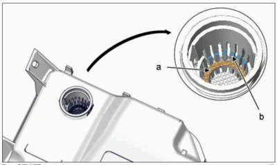

Drop the C5 down to its' lowest setting, and then take off the LDS cap. There is a 'basket' type of mesh in there, with some vertical slots lower than others. The LDS should be between these levels (lower are minimum, higher are maximum). This image may explain it;

The picture is to show the vertical slots only?
If yes the fluid is not even touching the base of the "basket".

In this picture there is no fluid. You can see the height difference between the slots. When the car is bottomed out (but not de-pressurised) you should see fluid between the lower and upper levels.
- x 6945
Re: Checking Level of LDS
The fluid levels should be checked with suspension depressurised (ideally), but as James says, put it on the lowest suspension level and wait for it to fully lower. The following diagram shows the levels for a C5 X7 - the BLUE being the maximum fill level and the ORANGE the minimum level.

I need to add close to 1.5 ltr of fluid to be between the high and low level!

GiveMeABreak wrote: 18 Oct 2016, 12:25 The fluid levels should be checked with suspension depressurised (ideally), but as James says, put it on the lowest suspension level and wait for it to fully lower. The following diagram shows the levels for a C5 X7 - the BLUE being the maximum fill level and he ORANGE the minimum level.
What about C5 mk1? Is it the same diagram?
- x 6945
Yes, same, do not fill above the blue mark and check on lowest suspension setting.

Level must be between A and B as per my last post, checked on lowest setting, engine can be running.
