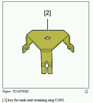

Thanks Marc. The tool is for the pump assembly retaining ring which holds the whole thing into the tank. I improvised there with an old screwdriver and hammer! Not pretty but with care works ok! The images only show the whole pump, sender and basket assembly, item 6 on the parts pdf. The actual pump is mounted inside that basket. So it seems it wasn't intended to have the pump itself replaced, hence the issue with the tubes.
My situation is that I must be certain I can get the car mobile on the next trip, otherwise I face yet another expensive and time consuming journey. So I think I must replace the whole assembly. The logistics involved in obtaining the part and getting back over there tomorrow will be a challenge though!

Is that the tool to undo the big plastic locking ring?GiveMeABreak wrote:In the interim - Here's the said tool in case you want to start up the forge!
I undid mine with a large blunt screwdriver and carefully tapping around the edge with the use of a hammer.

Ha! Should've read further on to the next page before posting.HDI wrote:Thanks Marc. The tool is for the pump assembly retaining ring which holds the whole thing into the tank. I improvised there with an old screwdriver and hammer! Not pretty but with care works ok!

That would probably work but would introduce another problem, how to install it into the feed and return lines. They are moulded semi rigid tubes with quick release fittings on the ends.furriegurrie wrote:Would it be an option to use a cheap, standard in-line electrical pump between the existing pump and the motor? Or separate along side of the existing one?
Just so you can get the car home and fix it permanently there
If I had another car at my disposal I would just tinker with it until I'd fitted the pump alone but the Xantia is my only car. Looks like I can get a whole new unit delivered to me on Monday for £55, so that seems the best option in the circumstances. Then I just have to work out how to get over to the car!

So after a virtually FOUR HOUR journey by public transport to cover 32 miles, I finally sorted the fuel pump thing out! The complete replacement pump assembly arrived without issue from an ebay seller, it is a pattern unit but is identical although I suspect not as good quality as the OEM part. Installing it without the special tool that fits the plastic securing ring is a struggle as the pump assembly is spring loaded, so it wants to push out as you need to push down and thread the securing ring on! Took about a dozen attempts before the thread started without jumping off, during which time I exercised my profanity vocabulary with zeal!
Everything fitted though and very little diesel was spilt despite the tank being almost full, and it started within a few seconds.
I'll try to install the replacement pump I initially obtained, into the old pump basket. Will be useful as a spare for WHEN the pattern fails! I might even dismantle the faulty pump to determine what failed. I could, should even, do a youtube on it! I know I'd watch it if someone else did!
