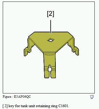

HDI - If you want the fitting / removal guide and the Parts list for reference PM me with an email address so I can send you the PDFs through as I can't load them here. YES - There is a special tool to needed to remove the pump - but you'll have a better idea (hopefully looking at the diagrams) and you might be able to improvise.

Thanks guys. It's looking like I may have to go the complete pump/basket assembly then. My problem is that the car is now 40 miles from home and due to my location travel is difficult and expensive, so my next trip must resolve the problem. Just wish I'd known about the tube connections and that a tool was required to remove the pump, I would have gone full assembly replacement from the start. The tube on top of the pump is a push fit over a serrated tail. I know that a heat gun will expand it enough to remove, but needing a tool to remove the pump is the issue now.

In the interim - Here's the said tool in case you want to start up the forge!
