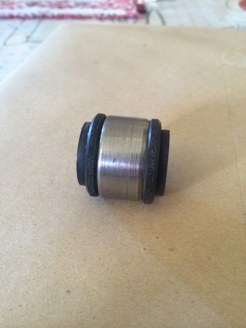

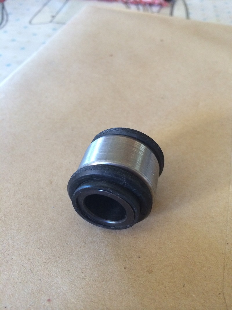

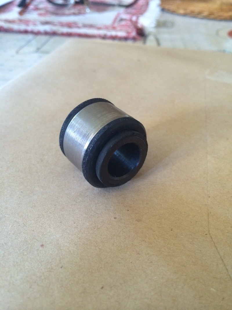

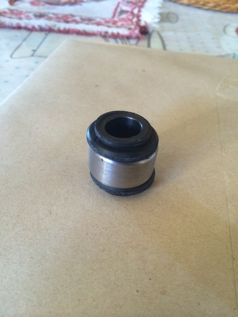

There's also a bush from a Xsara Picasso which is the same. This is the one I ordered. Here's pictures of it here...
Part number for this one is 405911. Currently retails at £11.59, as opposed to the £150 odd they want for the Activa ram bush. This is the part number of the one I purchased. It looks identical to the old bush. I've not yet fitted it as I didn't find out about this one until after I'd turned mine from Nylon66.
