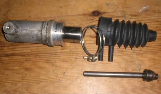

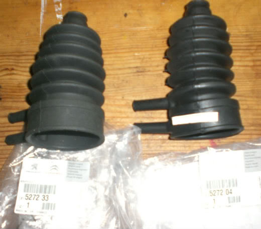

Malcolm (citronut) supplied me with possible part numbers for the boots with prices. I ordered both from the main dealer, and after an unpromising start where the ordering took about 45 minutes of waiting around, the parts came within a week.
I am fitting a rear strut from a sinker L-reg 1.9td, to an M-reg Non-sinker 1.9td. Both are/were Mk 1's with the cosmetic difference of chevrons on the bonnet of the older sinker.
The larger boot is appropriate for the "sinker strut", the smaller one for the "non-sinker" strut.
Question is are sinker struts, and non-sinker struts of this vintage the same, or similar enough to use.
They do look pretty much the same but maybe it is an optical illusion that the sinker strut, when fitted with the larger boot does look fatter than the non-sinker strut.
I will probably be able to salvage, repair the wire clips but I had to cut the threaded bolt to get them off. If anyone has ever ordered a pack of 10 of these clips and has them lying around it would probably be a better job to use a new clip.

I have now lost the one and only double wire clip for the rear suspension strut boot.
(placed temporarily on rear bumper when loading up the hound, shut the hatch, forgot about the clip and drove off.)
I was heading off to scrapyard central at West Sleekburn, and just as an aside none of the 6 or 7 yards down there had a Xantia in.
The double wire clip is about 60mm diameter, and there are some suppliers of double wire 'jubilee clips' on the internet, but I may be as well just ordering a pack of 10 of the right part. Maybe a pair of cable ties would do the job just as well.

Since you have already experience of this, do you have an idea if the two gaitors 527204 and 527233 are interchangable. I need the latter for my mk2 xantia estate, but 527204 is locally available. Otherwise i will need to order 527233 from france.

Wish I could help Aneesh, I did have the unused boot lying around for a while but probably sent it off to another forum member years ago. I couldnt be definite at all about compatibility. Would it be easy enough just to get the locally available one , match it directly with yours, and either keep it or return it for a refund. :?:
Is yours unrepairable?
