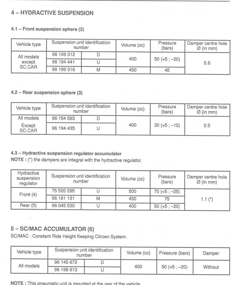

- Posts: 55222
- x 8463
They're different. They're both essentially accumulators but front/rear vastly differing pressures. The front is also a bigger volume as well.Diabolical wrote: I mean Front Hydractive bottom left hand side by the horn.
The front is 70bar 500cc whereas the rear is 50bar 400cc..

Thanks Jim
Have now ordered all that's needed. Already had 4 corner spheres for non_hydractive, I fancy a soft/damper ride.
I'm surprised only 50 BAR is on Accumulator sphere.
Front Hydractive is the same as XM it seems.

That accumulator (SC/MAC) is the anti-sink accumulator, not the front one attached to the engine, be careful when you unscrew an anti-sink sphere as there is the serious risk of twisting the hydraulic supply pipe off, make sure you loosen the union then hold a spanner on the union as you undo the sphere.Diabolical wrote:I'm surprised only 50 BAR is on Accumulator sphere.

Aha, this is the confusion the Guy at Europarts and I had, he said: we have no Anti Sink so I said: don't bother with that I shall just have main Accumulator.DickieG wrote:That accumulator (SC/MAC) is the anti-sink accumulator, not the front one attached to the engine, be careful when you unscrew an anti-sink sphere as there is the serious risk of twisting the hydraulic supply pipe off, make sure you loosen the union then hold a spanner on the union as you undo the sphere.Diabolical wrote:I'm surprised only 50 BAR is on Accumulator sphere.
Thank you for pointing that Out Dickie, could have made a bit of a cock up
