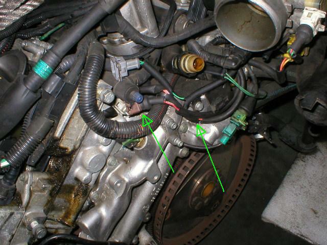

The Green (ECU) sensor is easy enough to get to. It's the brown Bitron that's a pain..
This pic shows it, just below the lower green arrow... The original picture was done to show the bleed valve locations.
