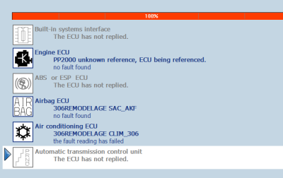

In PP2000:
Ecu Configuration and services -> Global test - takes forever to go through "Engine ECU" part, overall result is attached. The result is of course wrong, as I have MIL light on (and a DTC that I'm able to read via OBD2 dongle).
When I click on ECU row after scanning, I'll receive an info about incorrect matching of the ECU (incorrect engine, system or vehicle) and to contact technical assistance platform with ECU identification numbers.
Ecu Configuration and services->Test by ECU->Engines->Petrol->NFZ BOSCH MP7.2 will ask me if the engine can be started. If I answer 'yes' it will tell me to "check autodiagnostic line", and return to engine selection. If I answer 'no' it will tell me to check: transponder Peugeot, ignition controlled +ve to control unit and battery +ve to control unit.
It is the same regardless of which VM I use.

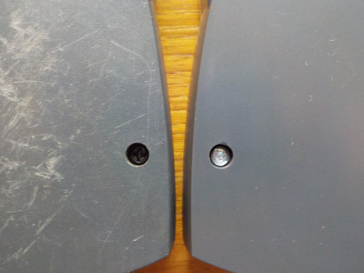

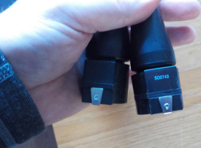

Most of your observations seem to be correct about the fake interfaces however I have a genuine interface & it is definitely made in France.
In the pics below the genuine one is always on the right.
The fake one i have here was given to me by a friend to test as it stopped working. I opened it up & there is some sort of burnt out relay.
Anyway my observations between the real & fake ones are:
I had never noticed the numbers printed on the round connector before as its always had the little rubber scratch protector on it.
The serial numbers on the fake are indeed the ones you say.
- The fake ones don't come with the stickers applied but come on a separate sheet, unless you have a robotic hand theres no way your getting them stuck on like they came out the factory & I'm pretty sure there will always be signs of them not being perfect
- There is an obvious difference in colour of the main sticker here but I suspect this may be down to usage oily hands etc. Mines is well looked after & always kept in a ziplock plastic bag when using to keep it looking new. This unit is about 13/14 years old believe it or not
- The fake one has a round CE sticker on it that was definitely not on the original
- The screws holding it together on the fake one are black Philips head, the real one small silver Torx heads but with a slot so a flat head can also be used
- The sticker on the back of the real one says made in France as it does on the fake one. I can't imagine the would not have just copied an original one??
- The little loop thingy where the cable goes into the interface is on the opposite side of the real one

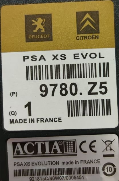

Just to be clear- I've never said that I own an original VCI. I said that I own one "that looks like" (because from what I know, there are some that have missing components inside), and that I tested it on another vehicle (to rule out that it's busted).
Buying original one (which are also hard to come by) for a garage/hobby use wouldn't be financially reasonable.
Mine also has an additional sticker on the back, but otherwise fits the clone description.

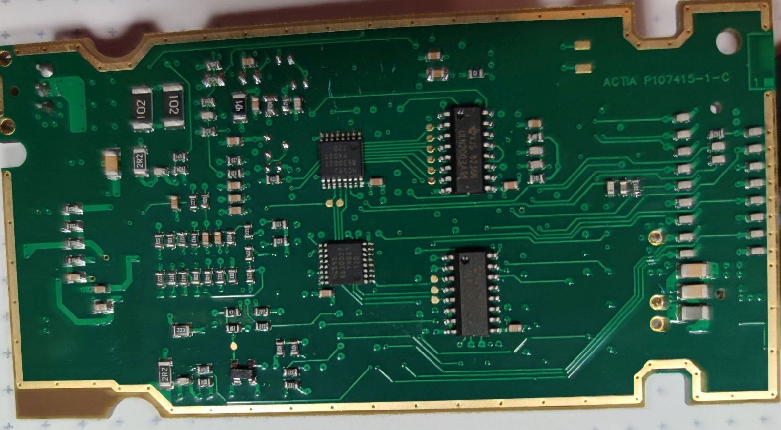

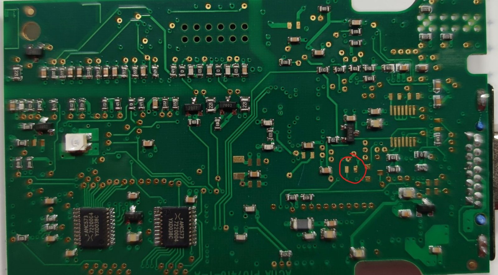

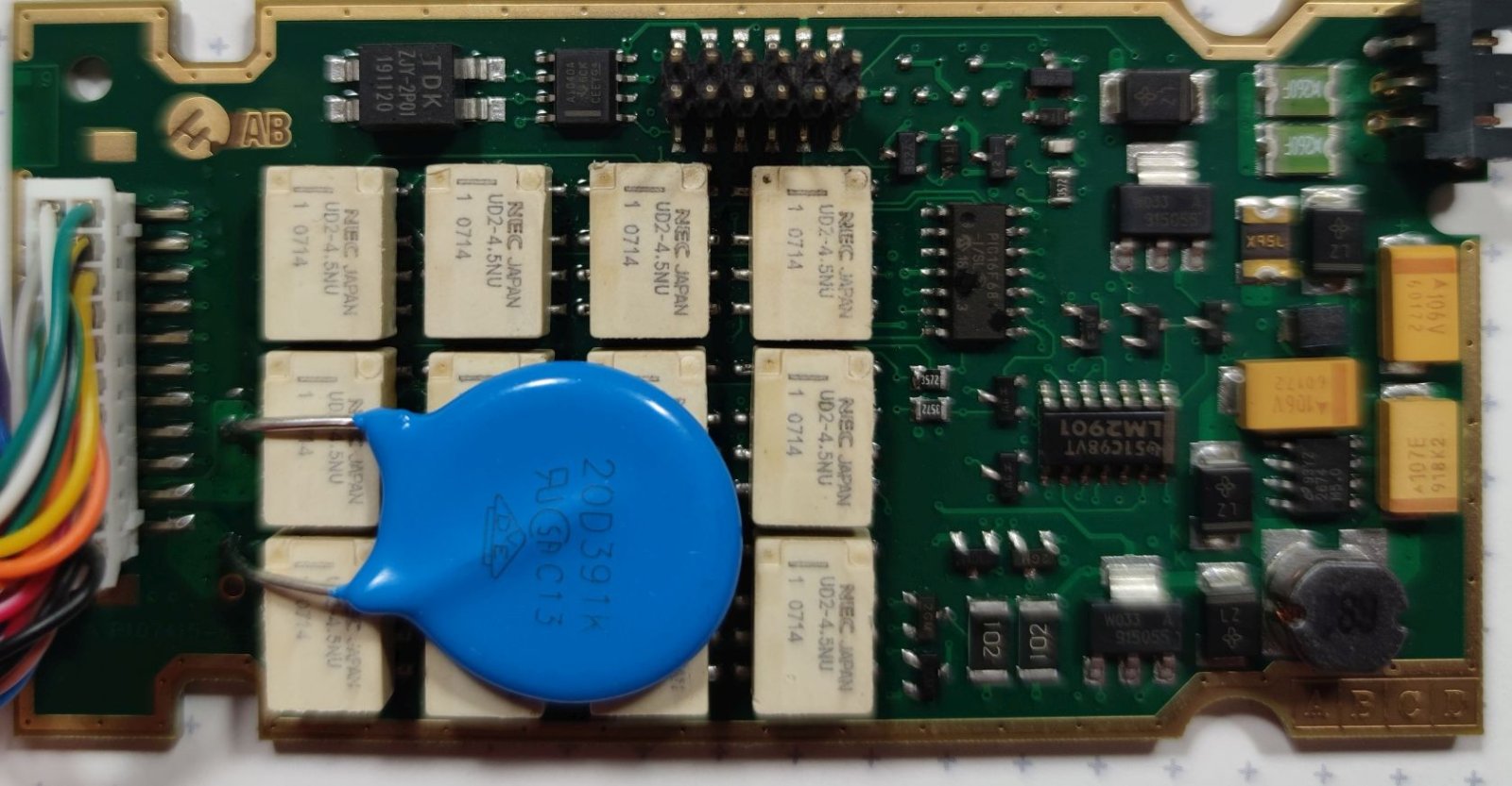

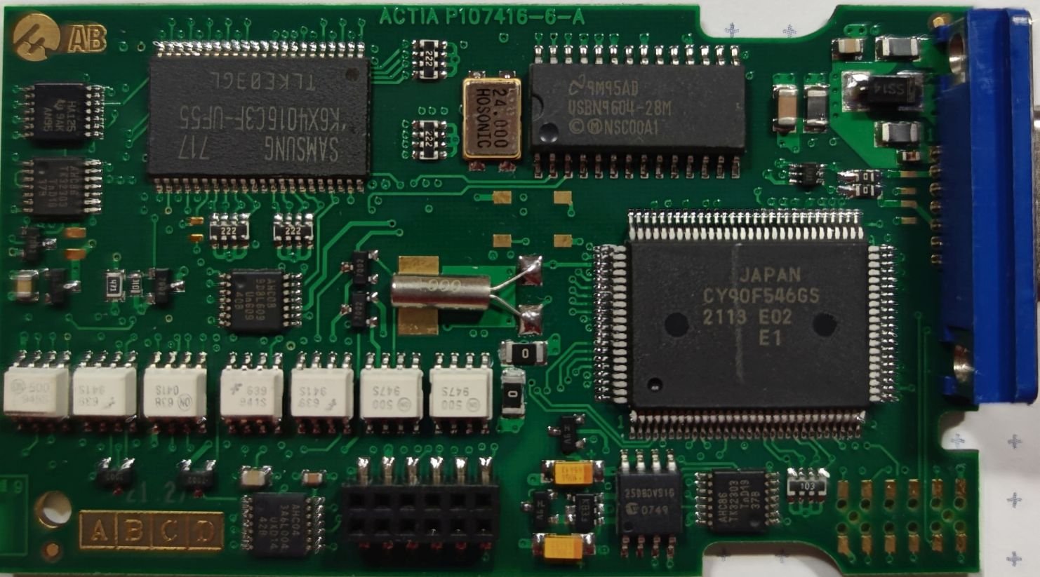

If you mean this one https://www.easydiagnostics.co.uk/produ ... t-vehicles then mine (set) looks identical.cit-rotti wrote: 21 Nov 2021, 16:50 But a good clone VCI (easy-dignostik) costs between 150 - 160 €.
At least from what I can tell from their photos, that appear to be just sourced from the internet. Fun fact- the first one has a polish invoice in the background.
I'll just leave the reference photos here. Although I did notice that a resistor is missing where I put the red circle.

Re: PP2000 with 306
I cannot write you a really good answer.
Pictures say nothing and pictures and advertising are only available from clones.
There are full-chip variants that are bad - and sometimes there is nothing under the "Cip hats" - and VCI with 2 chips that work correctly - even with the current DIAGBOX 9.xxx. Originals don't know a story like full-chip etc.
Most of the sellers are just dealers and buy in larger quantities cheaply somewhere and then have to get rid of the stuff - they have no idea about the diagnosis and the problems that come with it.
With easy-dignostik this is completely different and much better and has already been described more often in the forum. I have already bought there for a friend - perfectly fine - but expensive.
There are also forums that describe exactly what needs to be changed so that a VCI clone works like an original. The effort requires a good knowledge of electronics - it is usually not worth it.
