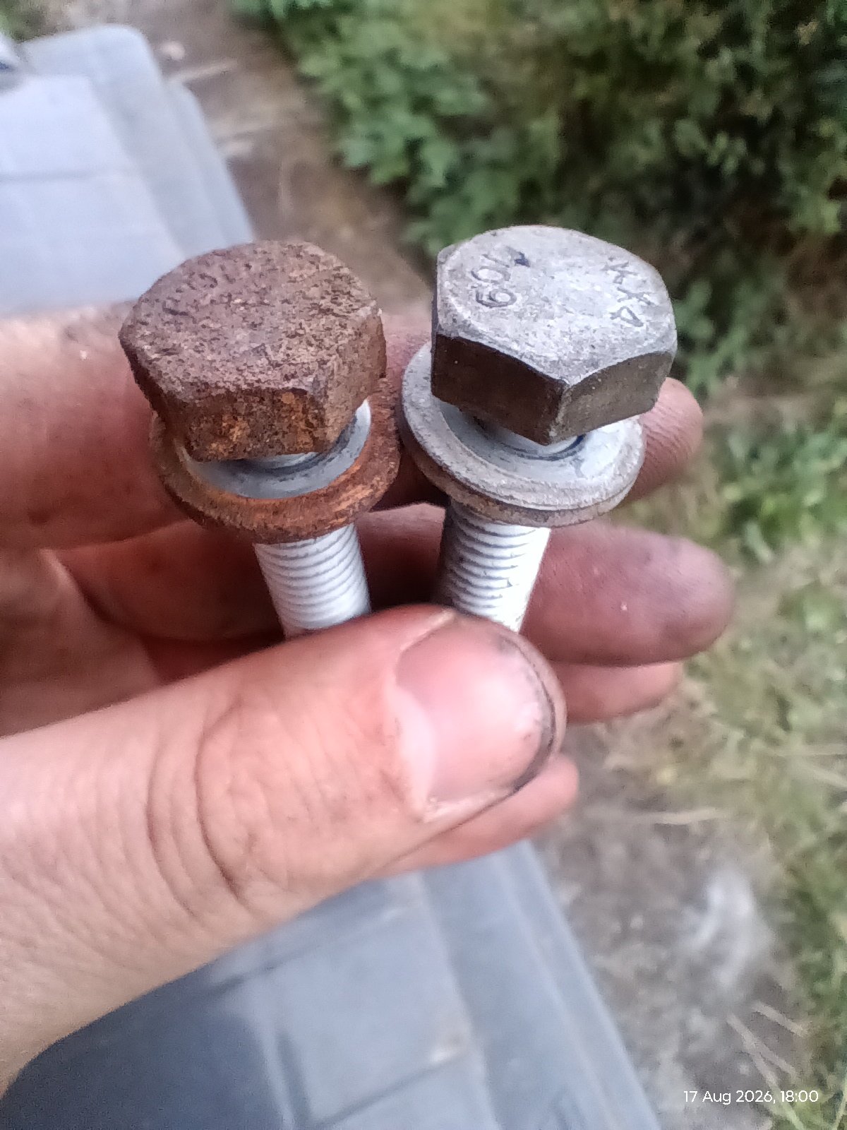

Pretty sure this was crusty horns relation one hung low , hence the rusted one and a clean one , he's now retired from the Clacton strip sceneMattBLancs wrote: Yesterday, 18:01 One of these bolts lives up high on the back of the engine, tucked up nice and warm with the turbo. The other down low front of the engine. Guess which is which ?

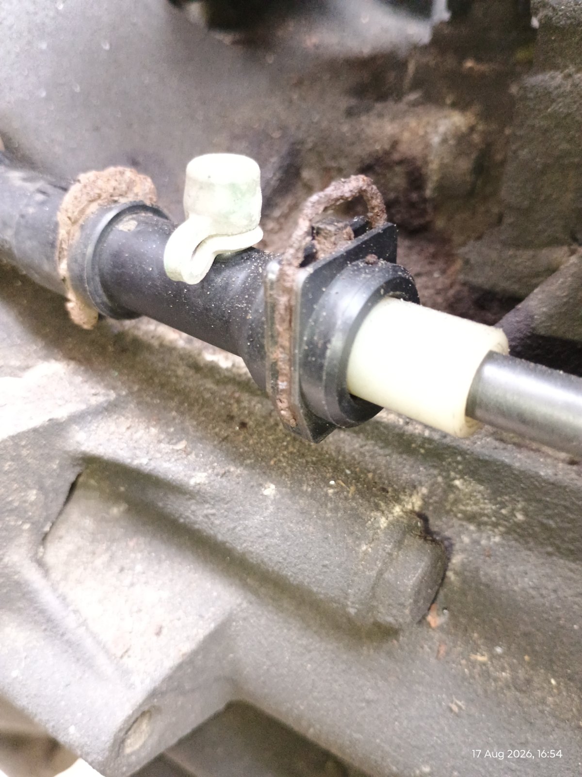

Ive not seen one that bad , has the car been in flood water ? The clips are available on ebay its just getting the right size , I once drew around one on paper then did the measurements sent photo of clip , my drawing , with all measurements written down and the seller found it , it might of been one of the ebay links in your thread.

How about:
https://www.ebay.co.uk/itm/205392845016 ... R8z4zpSCaA
OR:
https://www.ebay.co.uk/itm/333607405041 = dimension pic on this one
OR:

I'd say the 2nd link is the one

Don't think / hope!! It's been in flood water, and Colne (where I bought the car from) isn't by the seaHuskyxantia wrote: Yesterday, 20:47Ive not seen one that bad , has the car been in flood water ? The clips are available on ebay its just getting the right size , I once drew around one on paper then did the measurements sent photo of clip , my drawing , with all measurements written down and the seller found it , it might of been one of the ebay links in your thread.
I remember my blue 308 clutch clip was a bit rusty, but this is undoubtedly worse. I'll try and extract it tomorrow and take dimensions. Annoyingly this bit isn't part of the slave cylinder, effectively it's the end of the hose I think.

Thanks Mick, will have a measure in the daylight tomorrowmickthemaverick wrote: Yesterday, 21:00 How about:
OR:
https://www.ebay.co.uk/itm/333607405041 = dimension pic on this one![]()

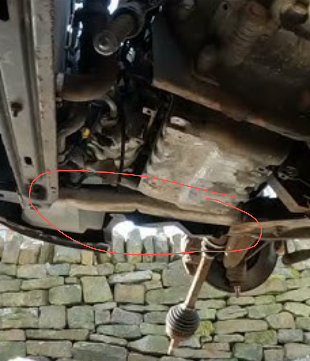

Just checking here's a quick image of first generation 308 underside: These bits = sub frame extensions?RichardW wrote: 15 Aug 2026, 18:43 Are you planning the drop the box, or leave it in and 'letterbox' it? Former requires the subframe extensions removing, which in turn needs the front bumper off to access the bolts for them (although if the arms have been done these will have been out to do them, so shouldn't be too bad. Latter requires that you drop the side of the subframe to make enough room to get the end of the box over the extensions - and the bolts like to seize in and spin the 'captive' nuts (which are only held in with a bit of plastic FFS!). Might be an unenviable choice....!
I recall them on the 2011 grey 308 but looking on the red 308 (2016) I don't think there is such a part, certainly not on this one (and no sign of it being removed / looking as though absent. Pictures tomorrow.
Above image from https://share.google/HtPMePOEvxuKvgGQx

Looks like the 308 does without the extensions / crash bars unlike the C4 Picasso and 3008 / 5008 - which saves you a job!
I expect you will need to rotate the box forward once free of the engine to get the diff out past the subframe.
