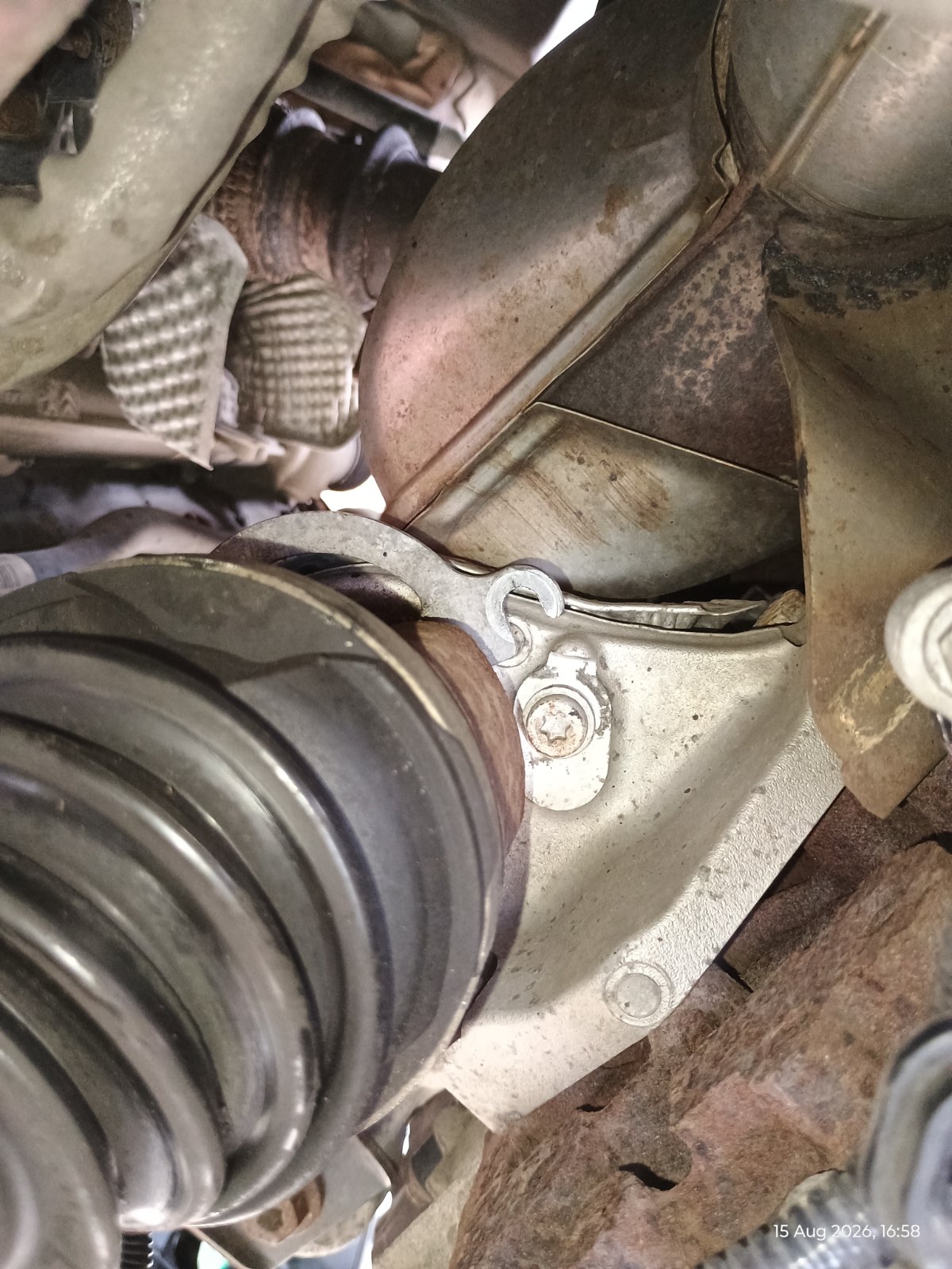

Few more pictures
Bottom ball joints both refused to come out from hub taper, so unbolted from wishbone instead. Wishbones look new - MOT advisory I thought I'd need to fix, already done = result! :)
One track rod end pretty ancient, other side looks new. Old one rubber on the edge of perishing I'd say. Will sort that soon. Wonder if I've a second hand boot I could put on it - as would save tracking needing doing (Vs changing track rod end complete)

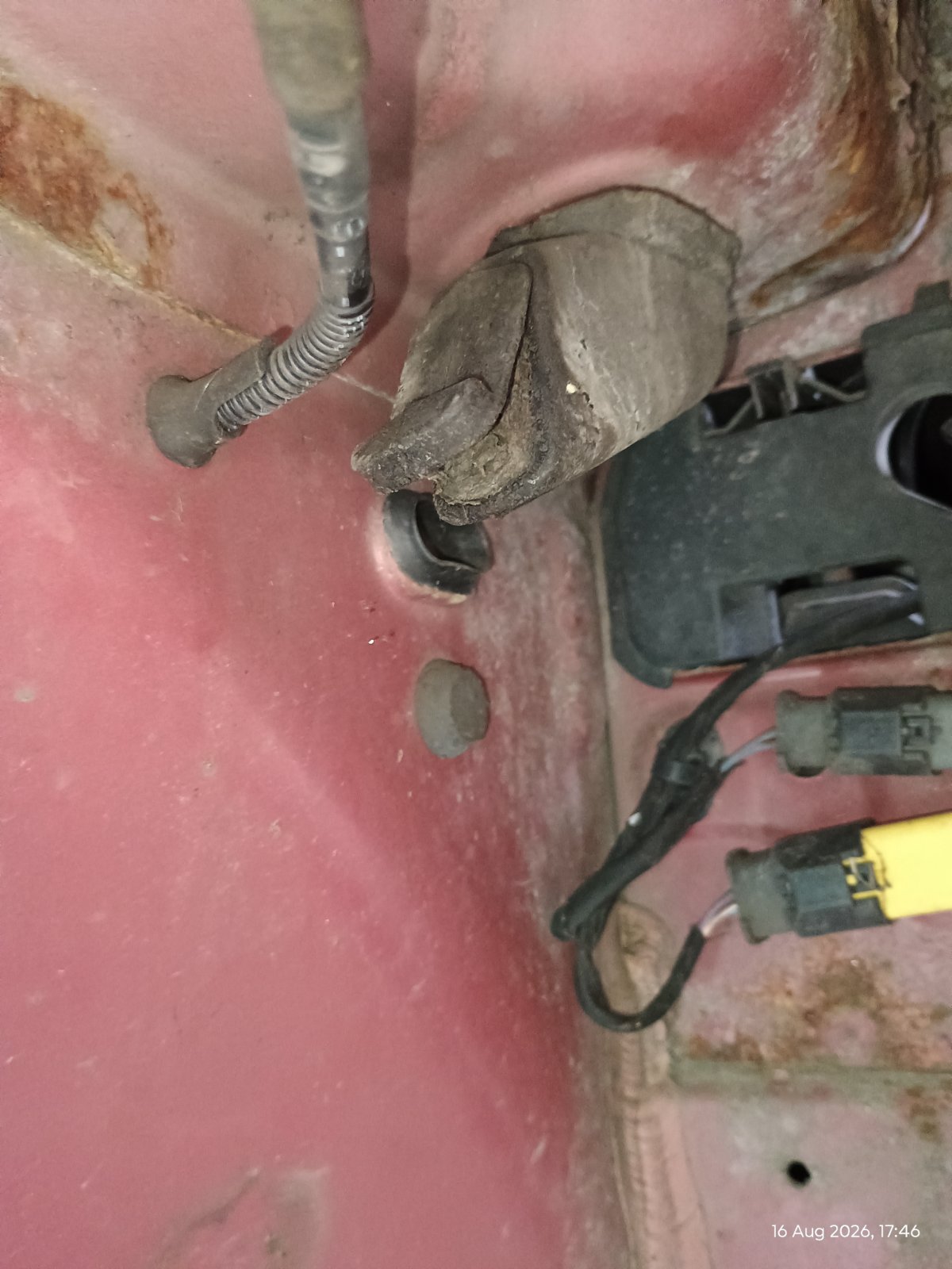

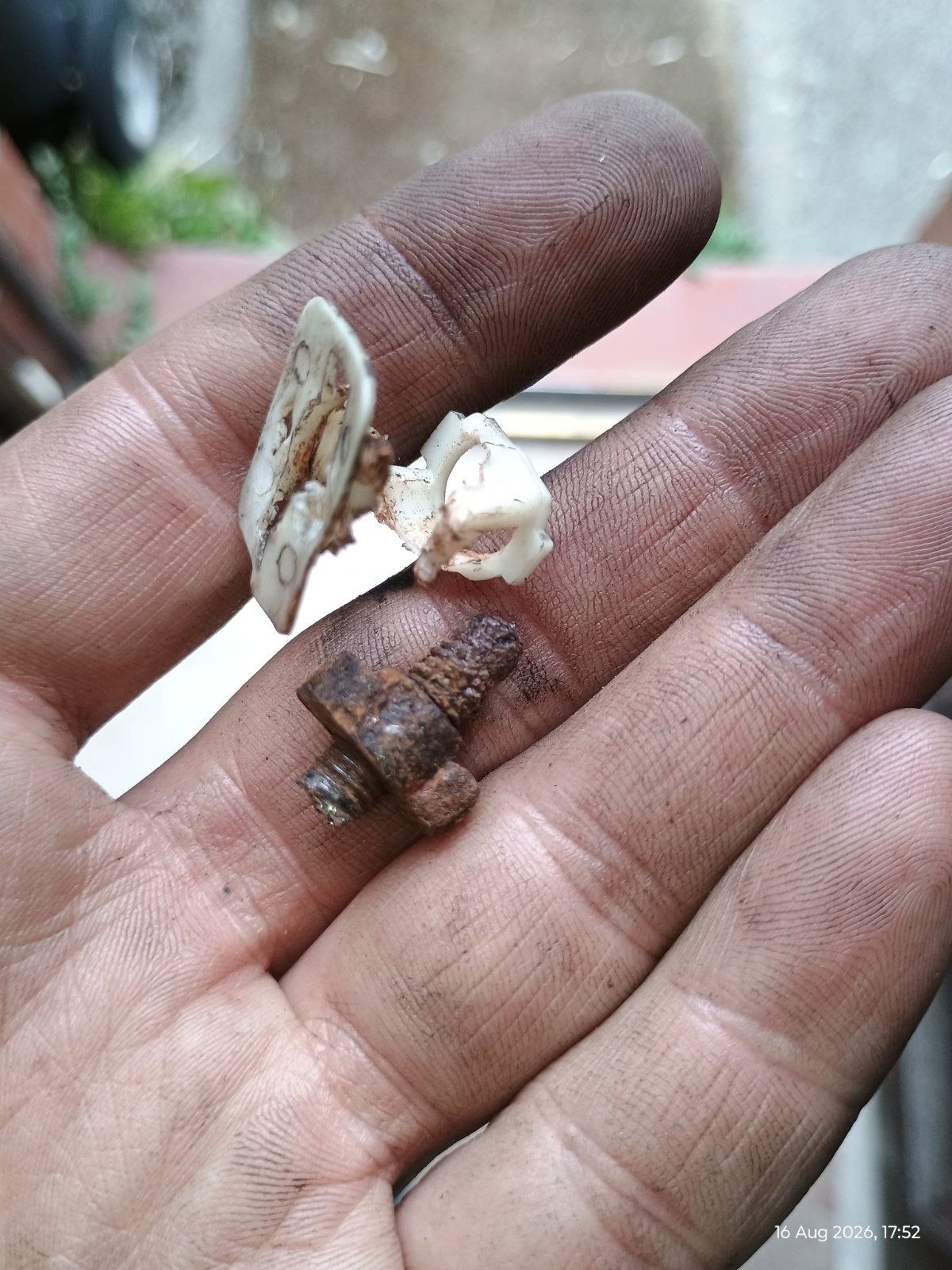

@Matt - good progress! Are you planning the drop the box, or leave it in and 'letterbox' it? Former requires the subframe extensions removing, which in turn needs the front bumper off to access the bolts for them (although if the arms have been done these will have been out to do them, so shouldn't be too bad. Latter requires that you drop the side of the subframe to make enough room to get the end of the box over the extensions - and the bolts like to seize in and spin the 'captive' nuts (which are only held in with a bit of plastic FFS!). Might be an unenviable choice....!

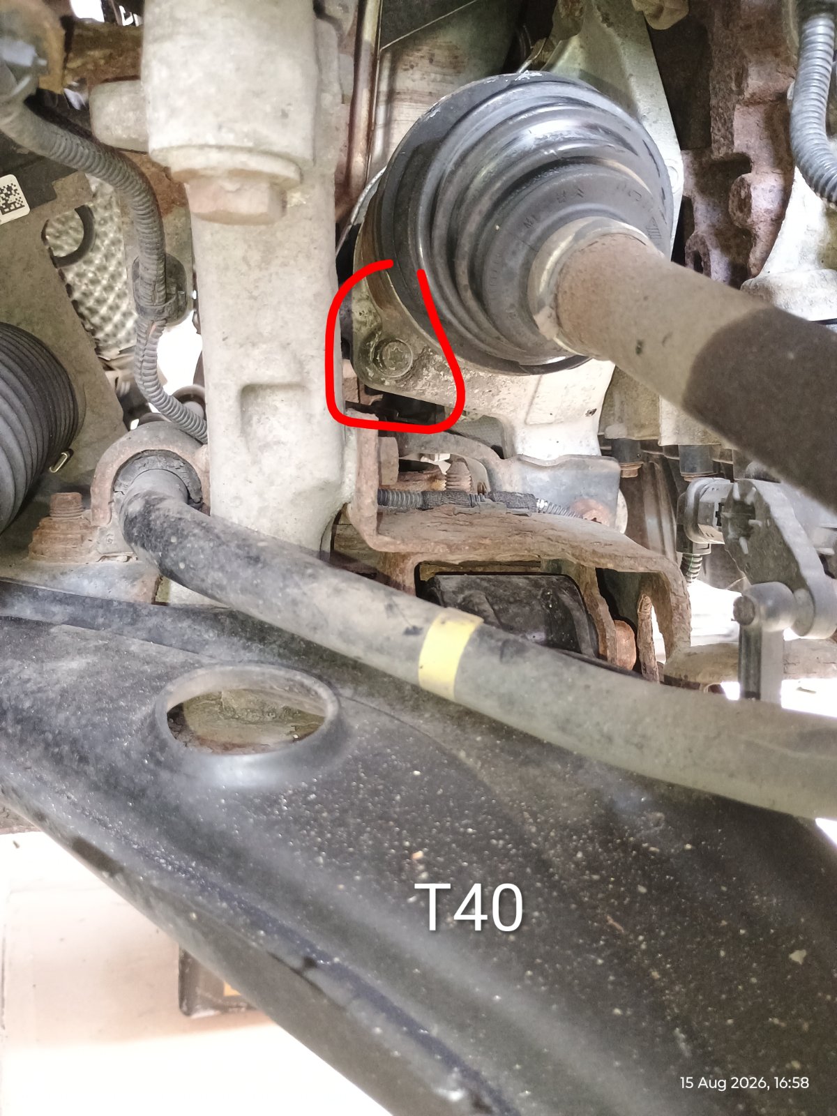

Probably drop the box - that's what I did on the C5.

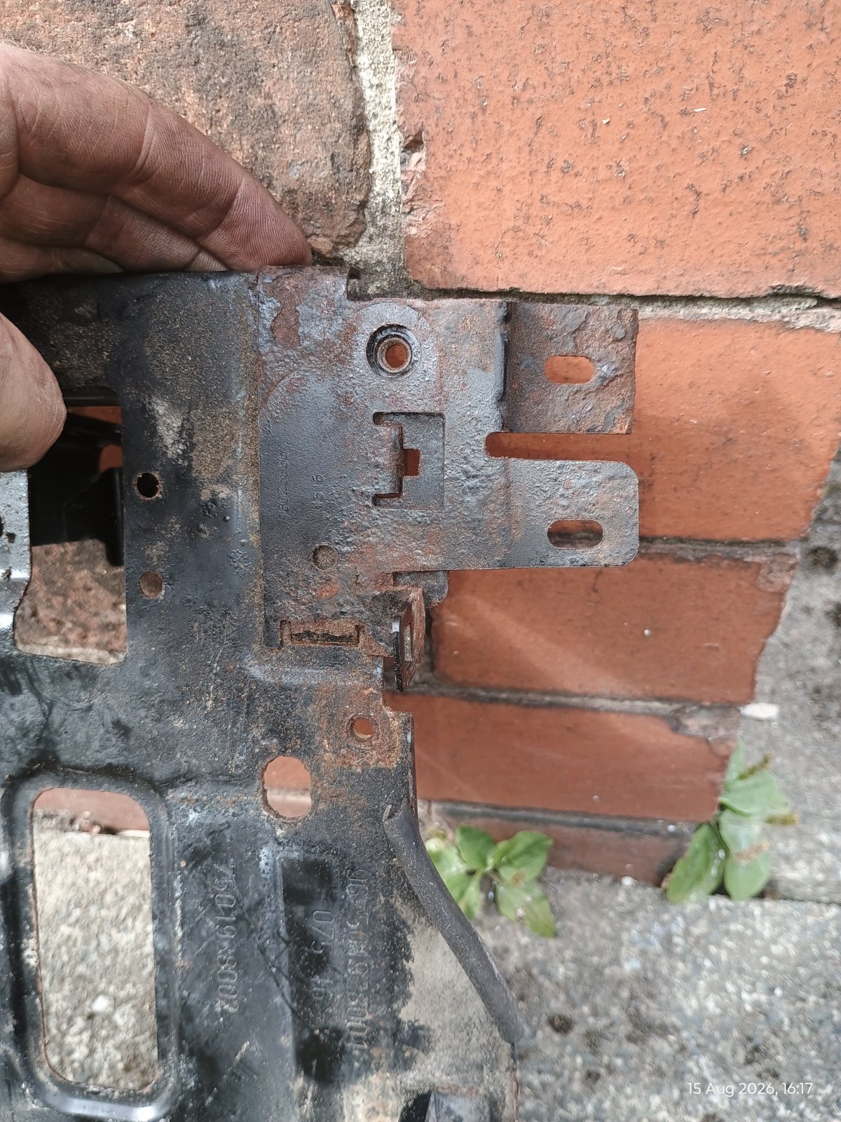

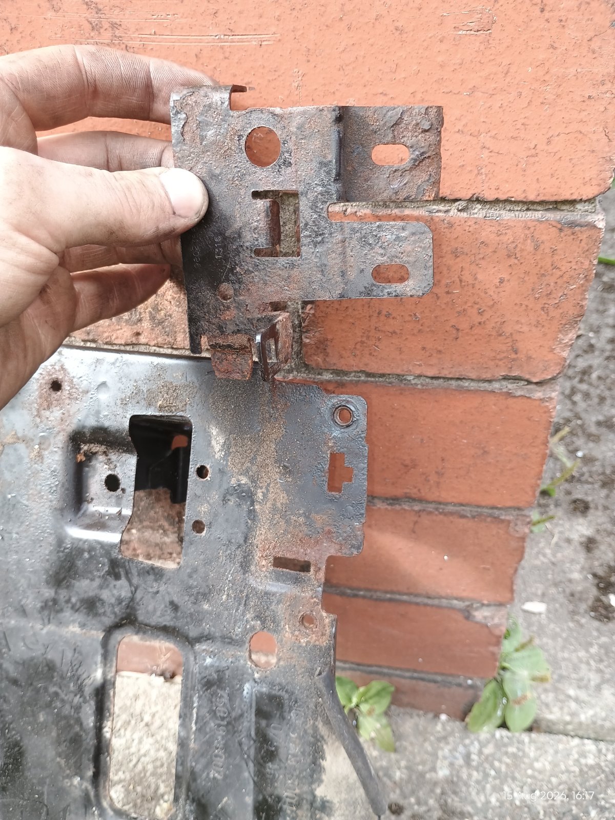

Underside of this thing looking a bit Scottish :rofl2: i.e. crusty, so suspect captive nuts spinning sounds likely.
A bit of rust treatment and repaint needed. Interestingly this has hasn't ever had a single advisory mentioning rust (to the extent I expected it to look like the blue 308 under here, it certainly does not!) caught just in time I think, not expecting to find holes but ready for treating before it deteriorates any further.

To be honest, I took the subframe extension off on the C5, but don't recall removing front bumper!? Hmm maybe memory failing me there!
(Bigger, longer car, more overhang - perhaps it pans out differently on the C5?)

Excellent progress Matt :D Loving that picture of 'Crystal Central' You could sell that as a work of art and recoup the cost of the car ;)

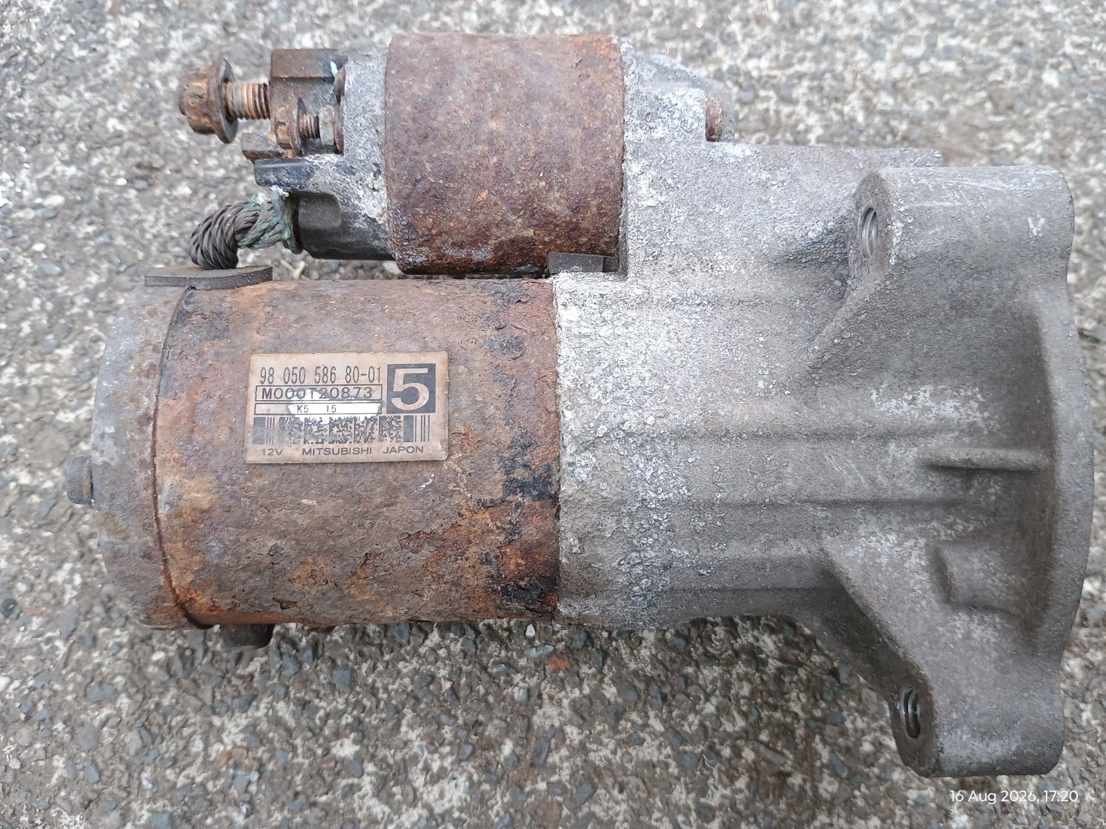

Look at the state of this starter motor! :shock:
Huskyxantia

Nice bit of crusty there lol

Huskyxantia wrote: 16 Aug 2026, 17:31 Nice bit of crusty there lol
Wouldn't believe that worked, would you ! :-D

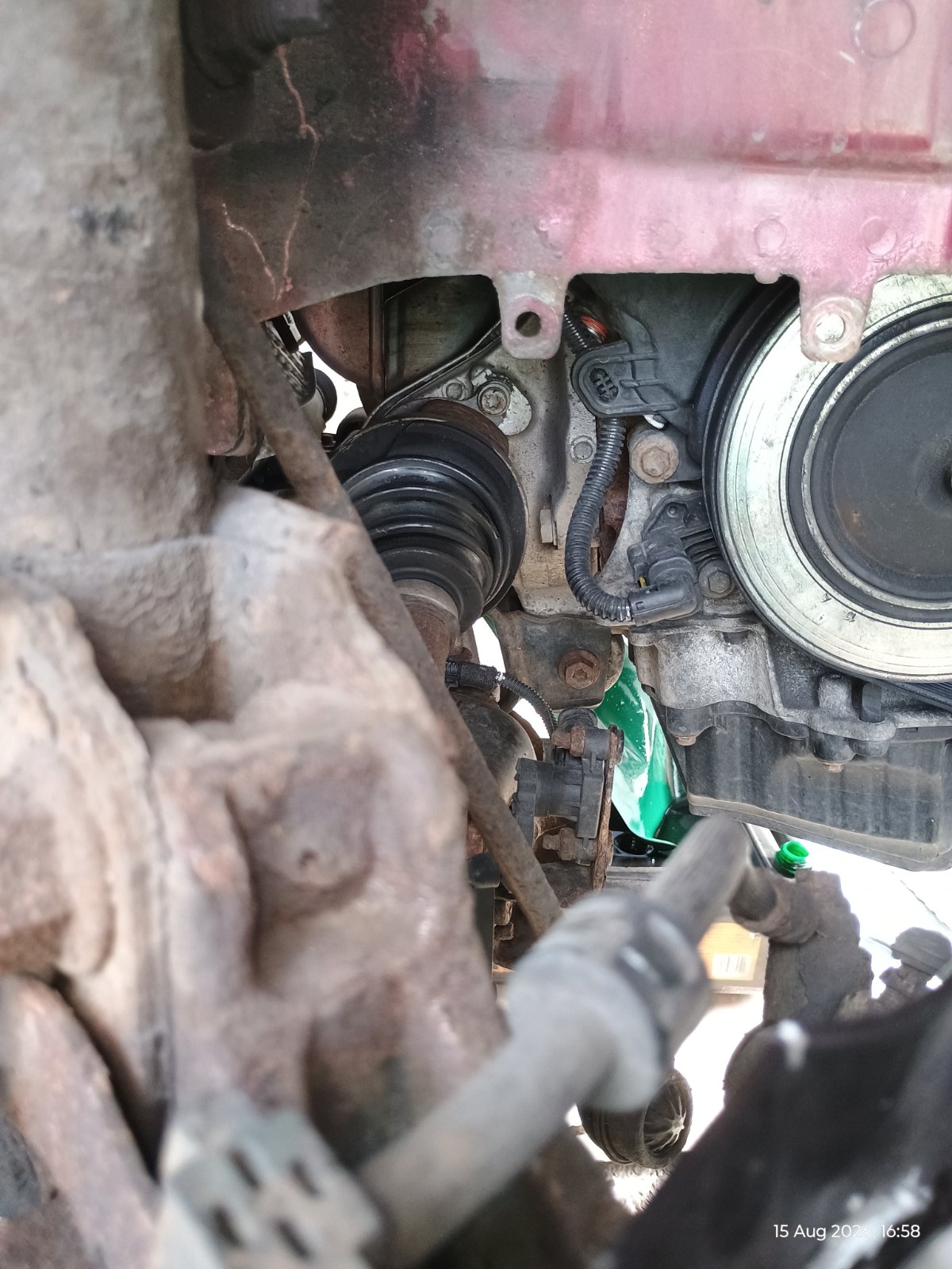

Unread post by MattBLancs »

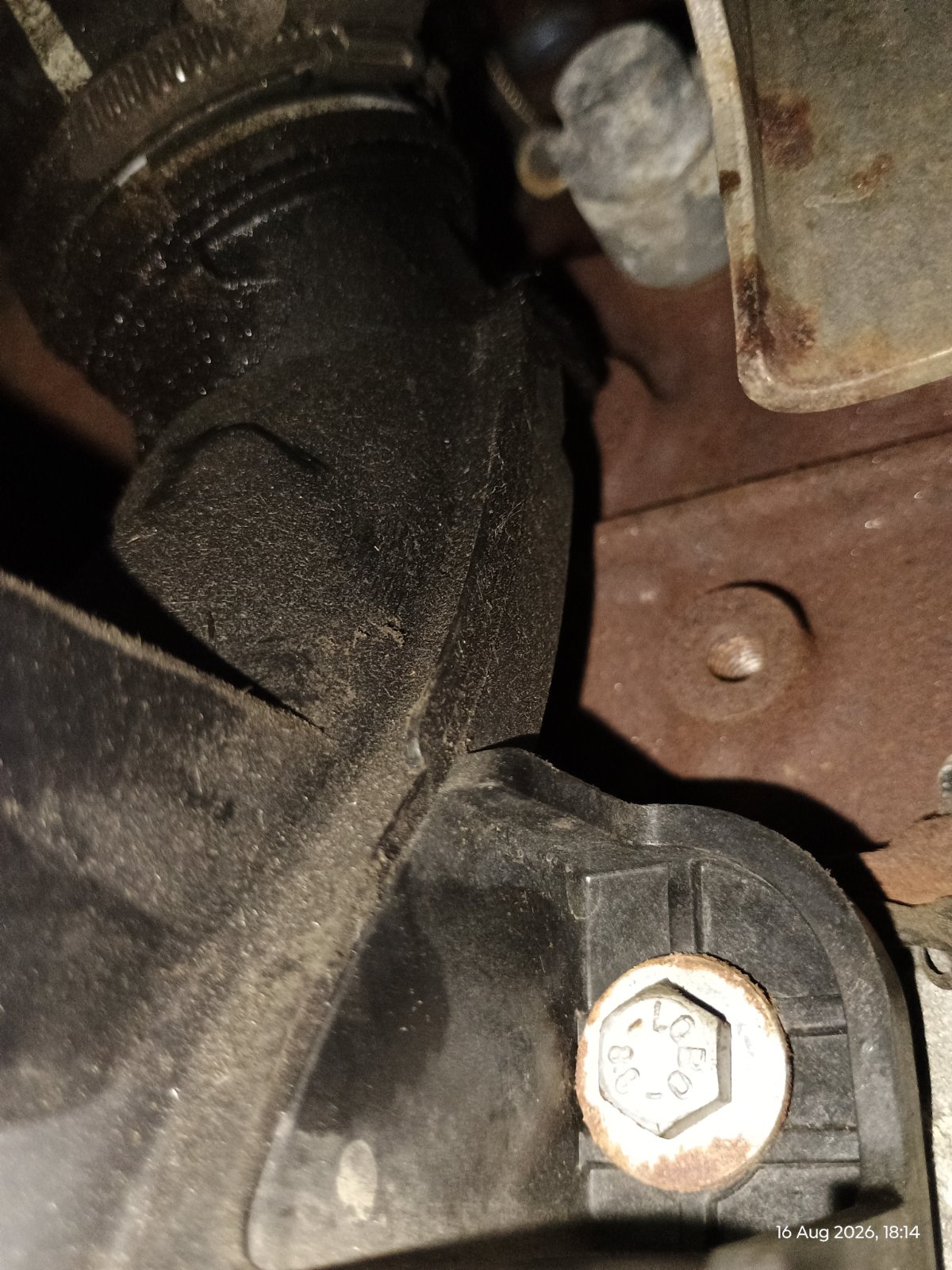

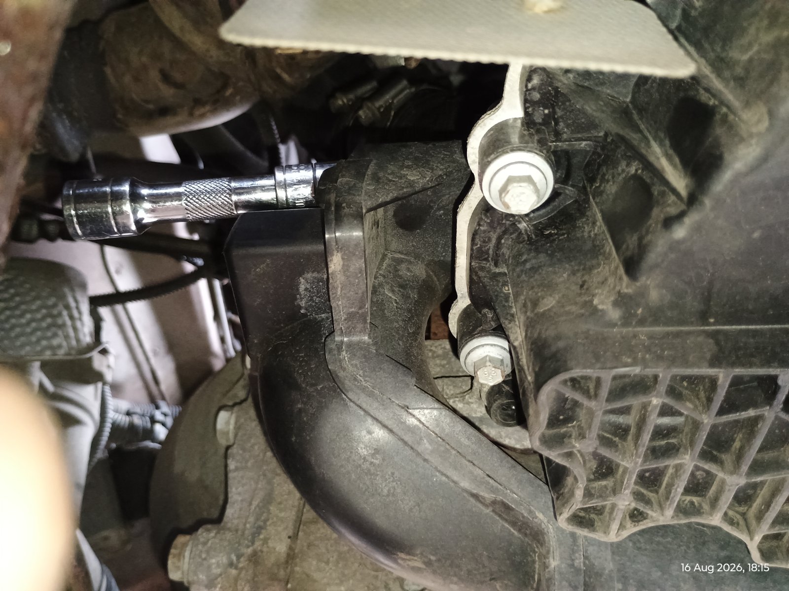

A few more photos, not a lot of time on the car today, so less progress made. Long driveshaft came out readily. Outer CV boot done with a cable tie on the larger end which works about effectively as telling it sternly to keep the grease in. What a mess. Horrible stuff CV grease. :)

Unread post by Huskyxantia »
Good reference photos there Matt and that starter motor was still doing its thing and in that condition is pretty amazing

That starter motor :shock:
Yep, cable ties on CV boots don't work - unless, it seem, they are on the outer boot of one driveshaft on a certain red AX I know...
I guess AX driveshafts are so tiny and spin so slowly they can get away with it!
