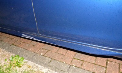

I need to paint the left side sill plastic skirt on our 308 after scraping it. Rattle can painting it off the car would be a lot easier than on it with no masking up needed. Pictures of the part (9806944977) shows it to be just held on to the sill by 14 clips so should just pull off. Has anyone removed it, hoping there might be some tips to avoid breaking it and damaging the sill paintwork ? I would get new clips before starting as these will likely break.

I have been able to have a good look and the skirt is partly lifted away from the sill in the middle so a clip might be broken or come out. From this it should be easy enough to work in both directions to get it off the car. I tried to push it back but it did not clip back so I may have no choice but to remove it. It is not much of a skirt, just a fancy strip of plastic so I hope not to find any hidden corrosion underneath. Only a few weeks ago I sprayed the inside lower edge of the Cactus driver's door due to rust and it took longer to mask up than paint, hence if possible wanting to do the skirt off the car.

Having obtained an aerosol (Fisher Motor Factors, Lincoln) I was going to remove the skirt today until I found it is coming apart. It is a box section with the inner part clipped to the sill and the outer part glued or some other way so the 2 parts are one piece. Where it is coming away from the sill in the middle is because the 2 parts are unstuck. The inner is tight against the sill so I have left it for now, possibly needing a new/used part if I can not glue the 2 back together. A new skirt (9806944977) is about £300 from our Peugeot dealer, used a lot less with some in Lithuania in the right colour. Insurance excess is £150 so probably not worth a claim as it may impact our other car's insurance.
