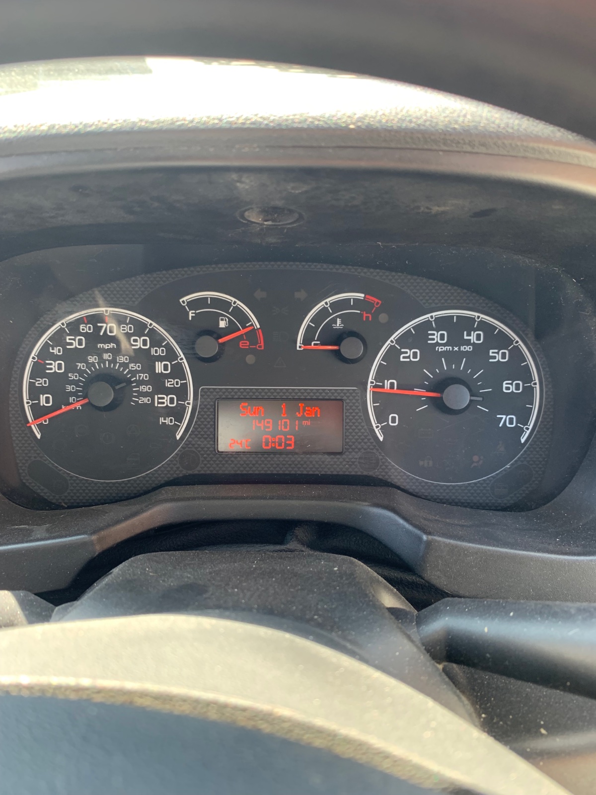

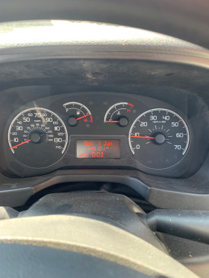

Ecu came plugged in no lights on and limp mode gone. Thxs everyone
