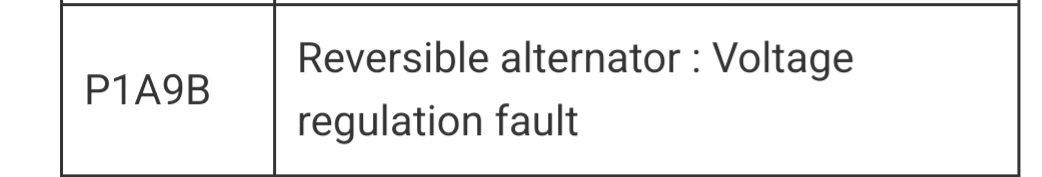

My mistake - the code is P1A9B!

Unread post by Sloppysod »
Yes that works. As you already know.

Sloppysod wrote: 22 Jun 2026, 19:15 Yes that works. As you already know.
At this point I'm thinking the problem is that the alternator is unable to regulate output, which the ECU registers and then stops it from producing current. Or, there is a nw/wire connectivity issue. In any event I need Diagbox to diagnose. Off to the dealers!
