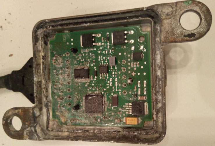

From reading around Google and forums I came to conclusion that NOx sensor is dead. Took off mine, from outside it was normal,
but I disassembled it and found lots of white crystals inside the chip.
I suppose that's probably salty water from puddles and that the chip is actually dead.
NOx sensor
NOx sensor

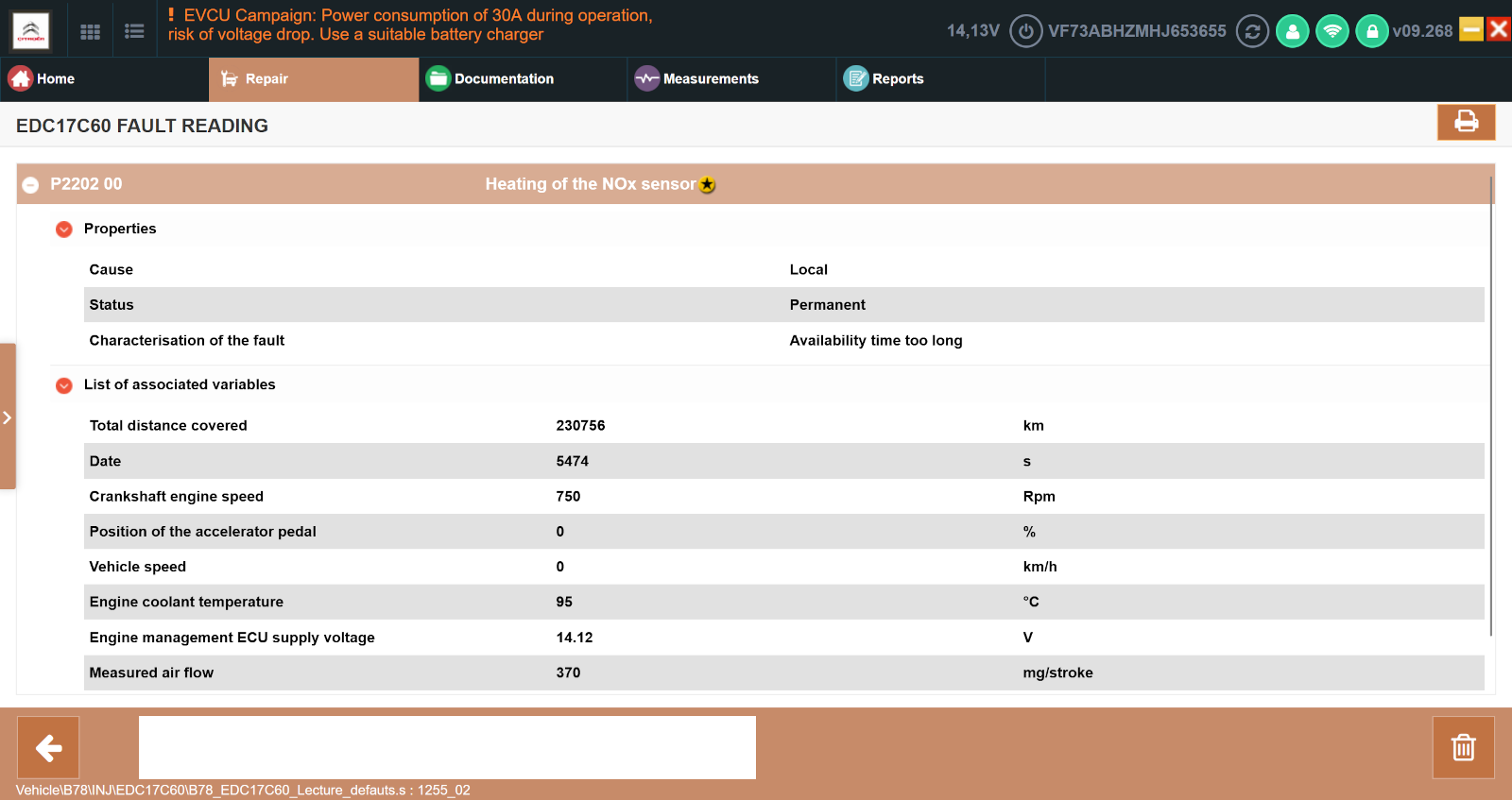

Now the new problem that I have is P220200 Heating of NOx Sensor - Availability time too long? What does this Mean?
Picture from Diagbox
It does not cause SERVICE on dash or anything but it comes up in Fault reading which is annoying.
Doing NOx Sensor Heater Test through Actuator Tests results in successful test with no faults.
Anyone had this issue before?

Problem has been solved!
Went around the wiring for the NOx sensor and there was a broken wire.
Everything seems to be working now.

ragingraven wrote: 15 Jun 2026, 21:41 NOx sensor is dead. Took off mine, from outside it was normal,
Hi, quick question - I know it turned out not to be your issue (thanks for confirming that too by the way!) but just to ask:
Was opening up the NOx sensor casing straightforward and do you think, reversible? (I.e. would it go back together again?)
Might be worth a spot of preventative maintenance to open it up and clean out the deposits??
Thanks

MattBLancs wrote: 29 Jun 2026, 20:58 Hi, quick question - I know it turned out not to be your issue (thanks for confirming that too by the way!) but just to ask:
Thanks
Heya, the NOx sensor lid was pretty easy to remove, so I don't see why not do maintenance regularly. Probably with alcohol though as you don't want to ruin it.
