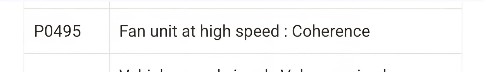

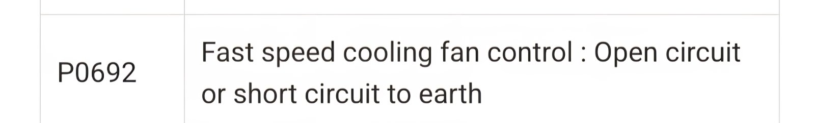

Hello,
Vehicle: Citroen C3 2006 1.4HDi 68hp
I’m dealing with two fault codes: P0692 and P0495.
Symptoms:
The overheat warning light keeps blinking constantly, even with the engine OFF.
Sometimes there’s also a warning beep.
The A/C blows cold air for a few minutes, then switches to ambient/warm air, then back to cold again in a repeating cycle.
What I’ve checked so far:
Replaced the coolant temperature sensor.
Checked the fan control relay and it appears to be working properly.
Coolant level is normal.
I’m trying to figure out what else could cause these symptoms.
