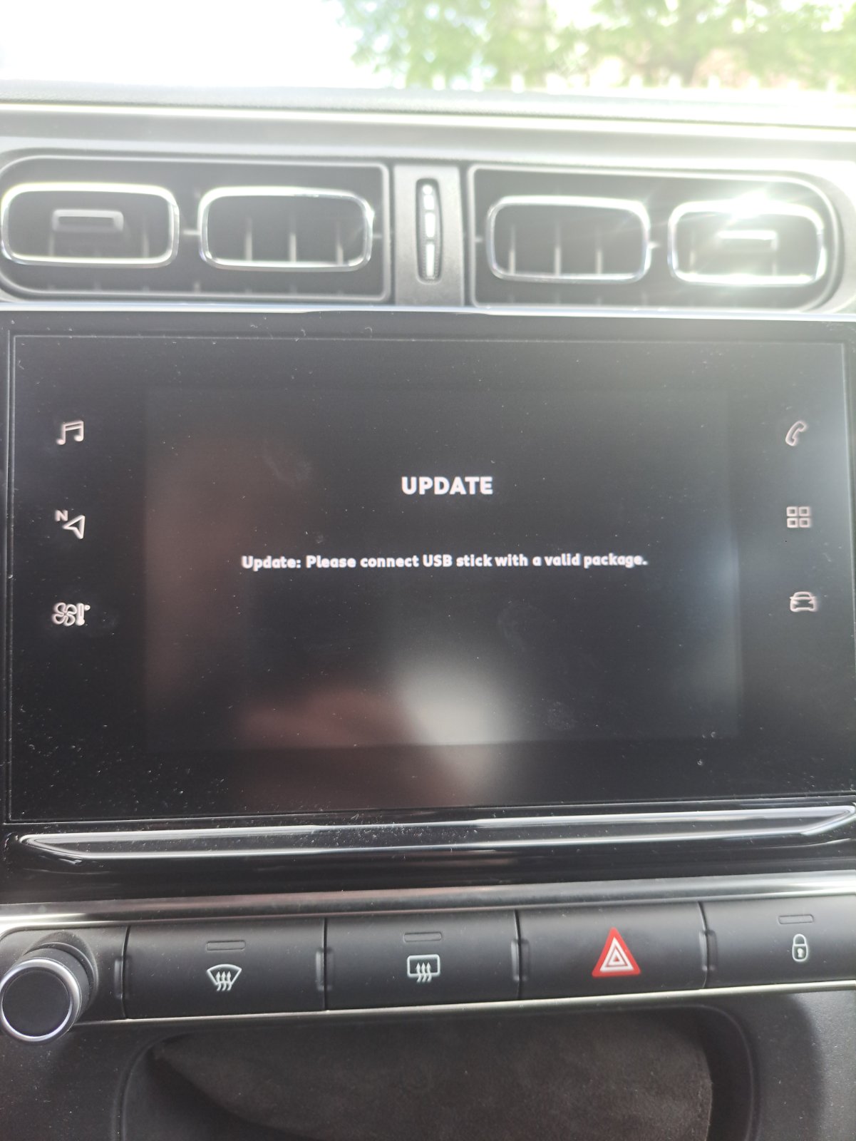

Ive updated the infotainment screen via USB through the official citroen app on windows11 but the upgrade was stuck at 54% for 60min , ive unpluged the USB and now its stuck in this screen.
HELP!
Citroen c3 2022 infotainment update problem

Re: Citroen c3 2022 infotainment update problem
What size USB stick did you buy, by default Windows 11 formats anything bigger than 32gb as ntfs, not Fat32.
See here to format bigger drives https://www.howtogeek.com/316977/how-t ... n-windows/
Have you seen these instructions, https://www.uktechhub.com/wp/wp-content ... System.pdf
If the following message appears « update failed »
- Remove the USB stick
- Stop engine
Disconnect the vehicle battery
- Wait 5 minutes
- Reconnect the vehicle battery
- Insert the USB stick
- Start the entire procedure again with USB stick.
- Stop engine
- Wait 5 minutes
