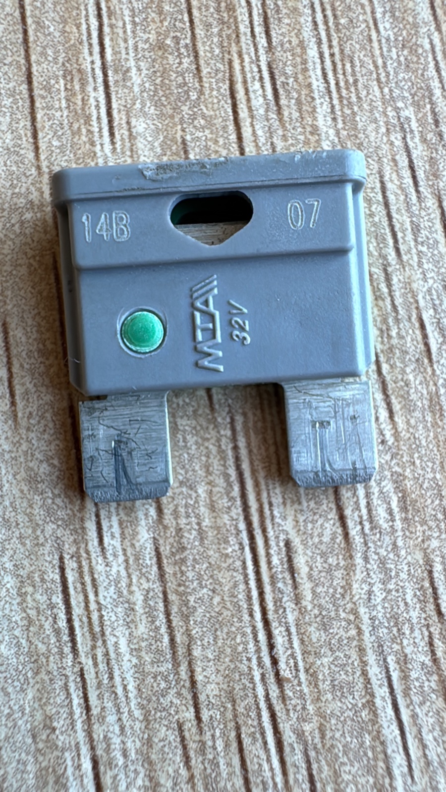

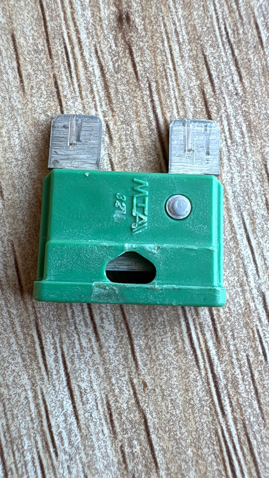

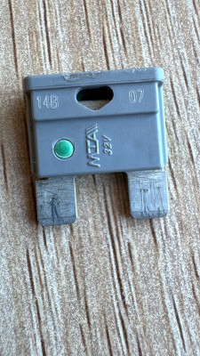

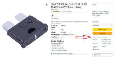

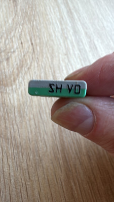

I’m having trouble finding a fuse I need and my car has completely stopped and I can’t even lock it.

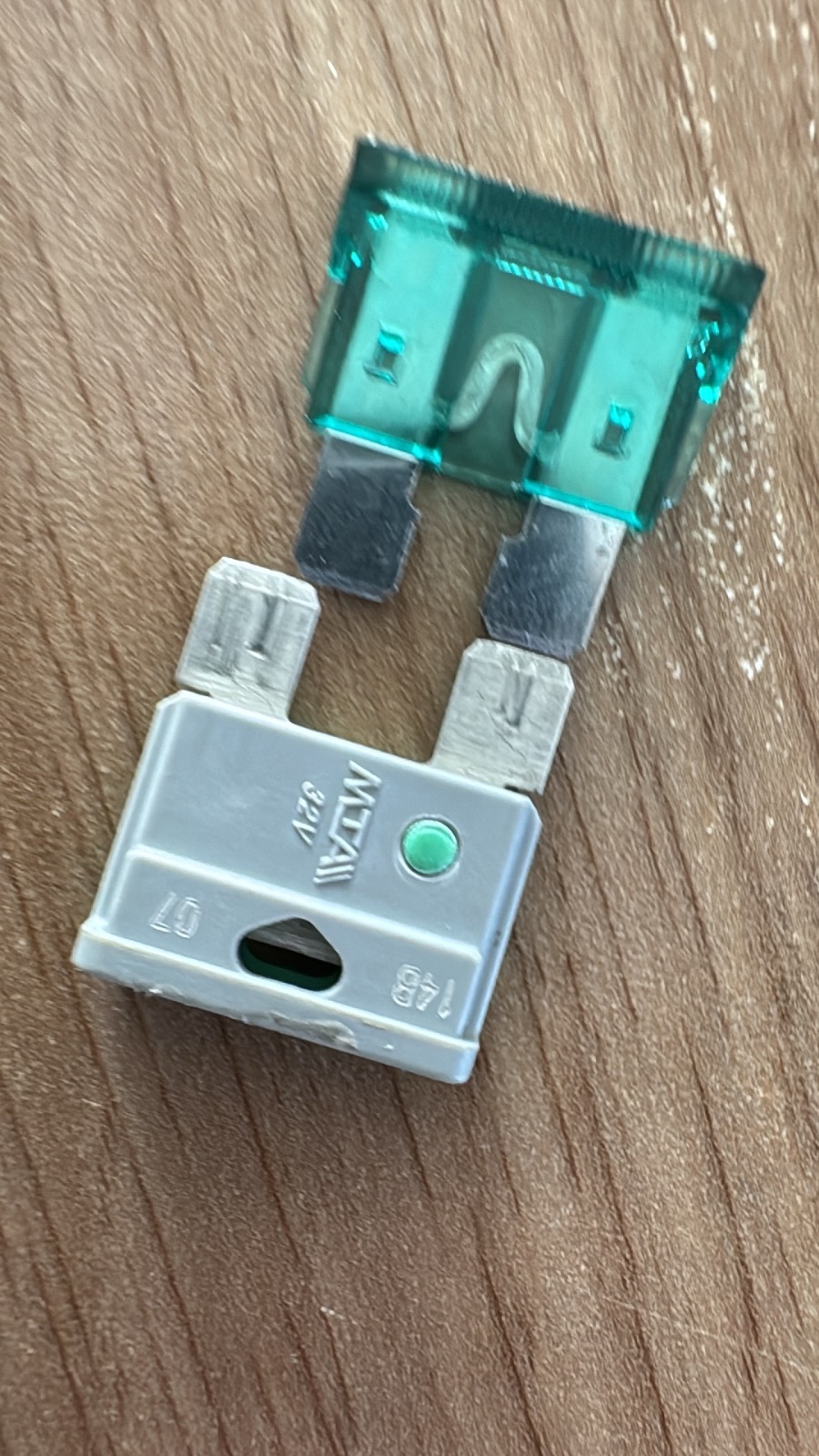

It’s wider than other fuses too

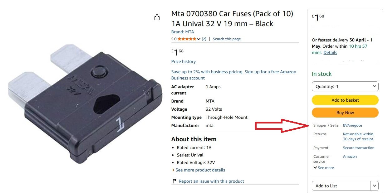

Try this supplier:

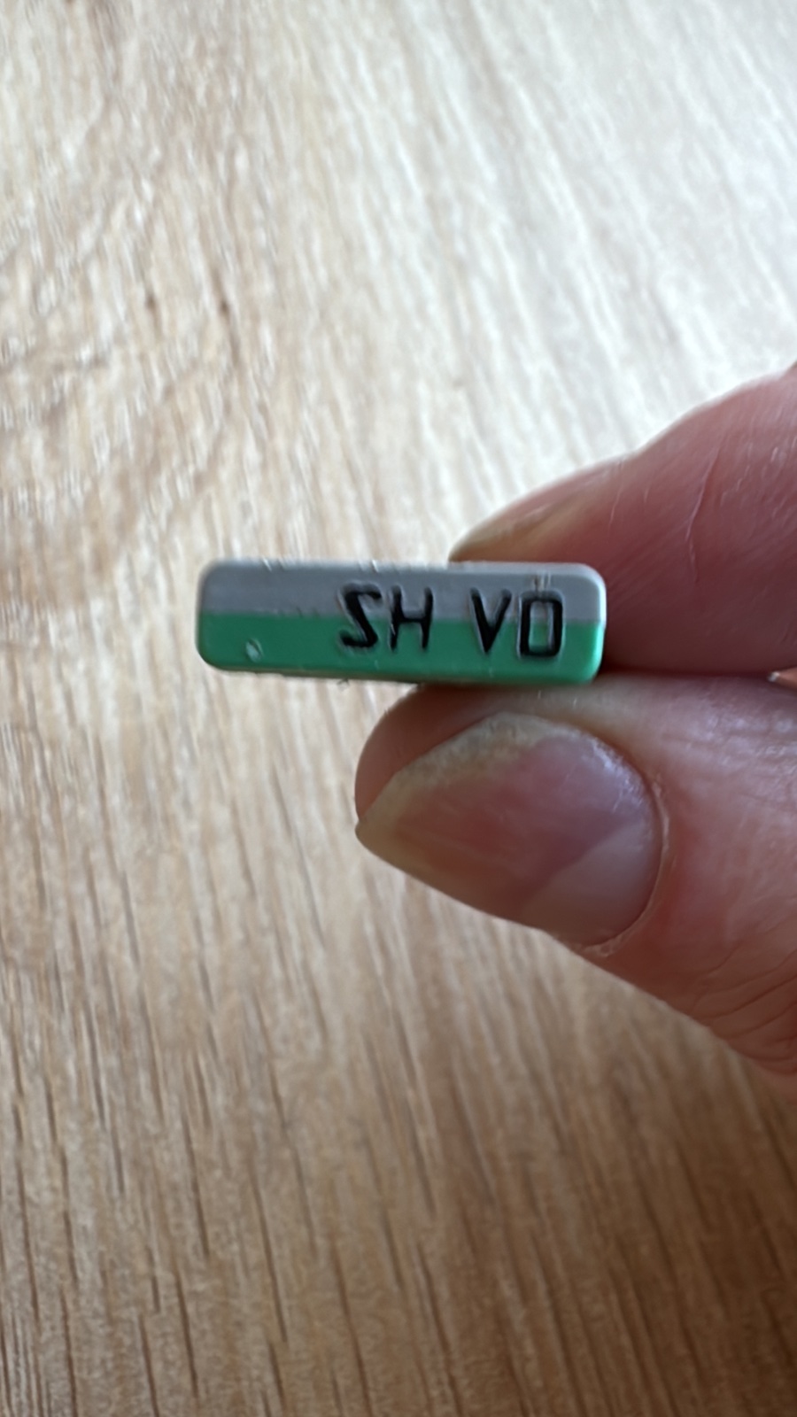

That looks like the 'shunt fuse'. It is not a fuse; it is used to switch the car between 'showroom' and 'customer' settings.

Re: Fuse help!,
It's called a shunt and deliberately has different spacing so as not to be mixed up with ordinary fuses - something, would you believe, I only learned about recently.

If you've got a multi meter check the integrity of the shunt, and that it is in the 'customer' position (which might not be that easy to see!).

Re: Fuse help!,
Has the shunt actually blown? If it has thats a first for me. As above have you confirmed with meter to see if it has continuity?
