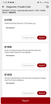

Hi can anyone help me 2.0L Peugeot 2015 508 hybrid ? So my wife started the car in the morning and stop car engine fault popped up in the dashboard, she stopped the car and since then won't start . I checked fuses and I found a 5amp fuse blown on top of the battery on the bpga I belive its called I changed it and notthing . I checked bpga and every thing its fine on it has voltage at the end every fuse has continuiti. the only error I have is B182D power fault between internal combustion engine and the traction battery. I checked traction battery main fuse is good and installed properly so I'm running out of ideas. Ps the B180e is not present anymore

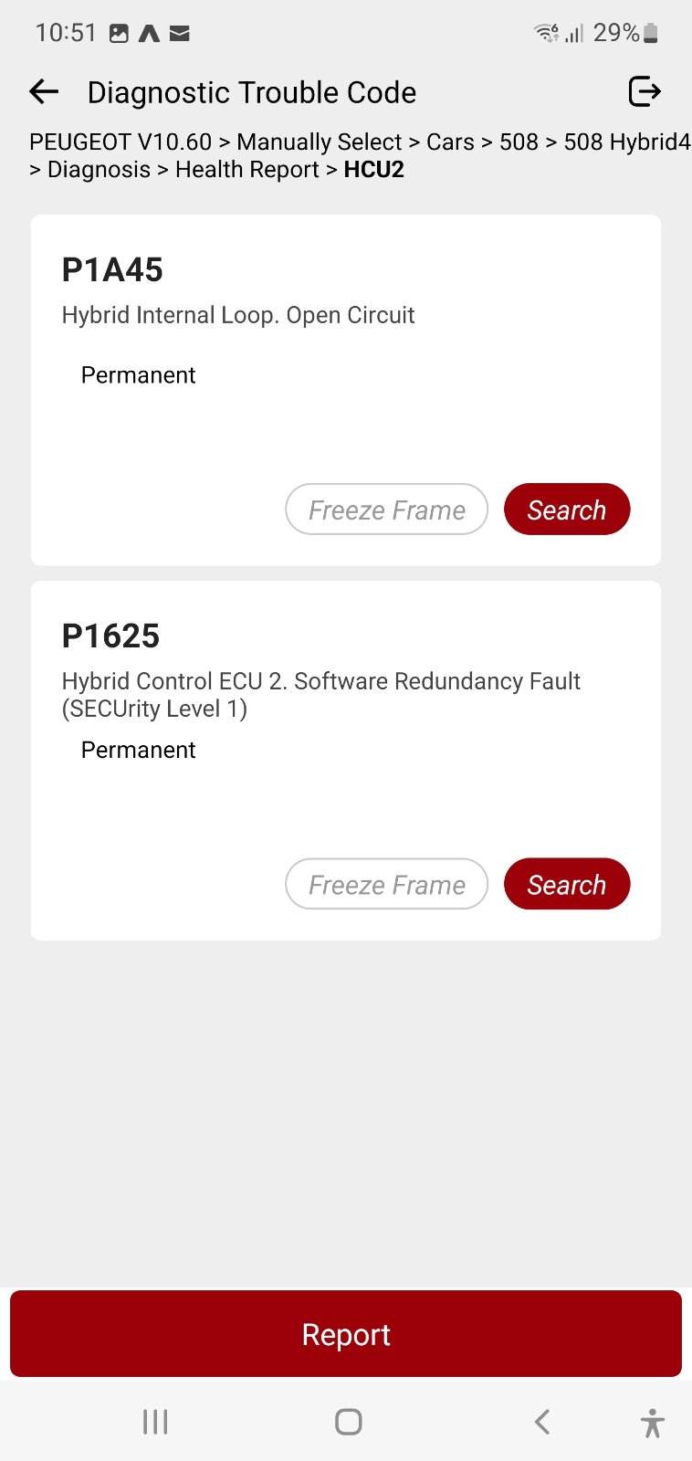

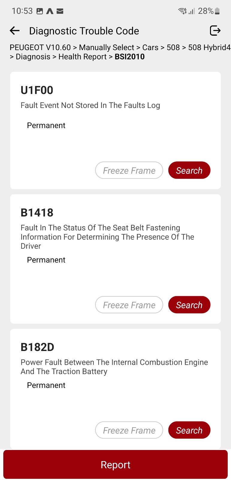

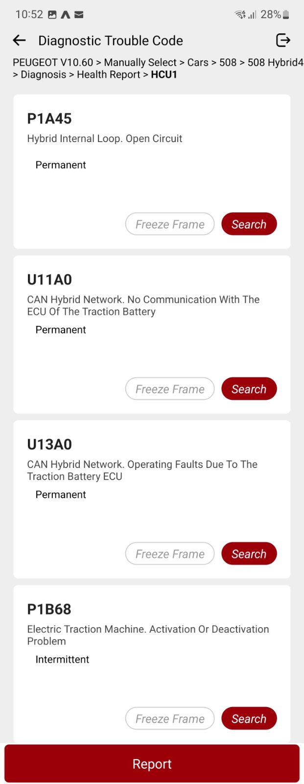

Re: 2015 2.0l Peugeot 508 hybrid wont start

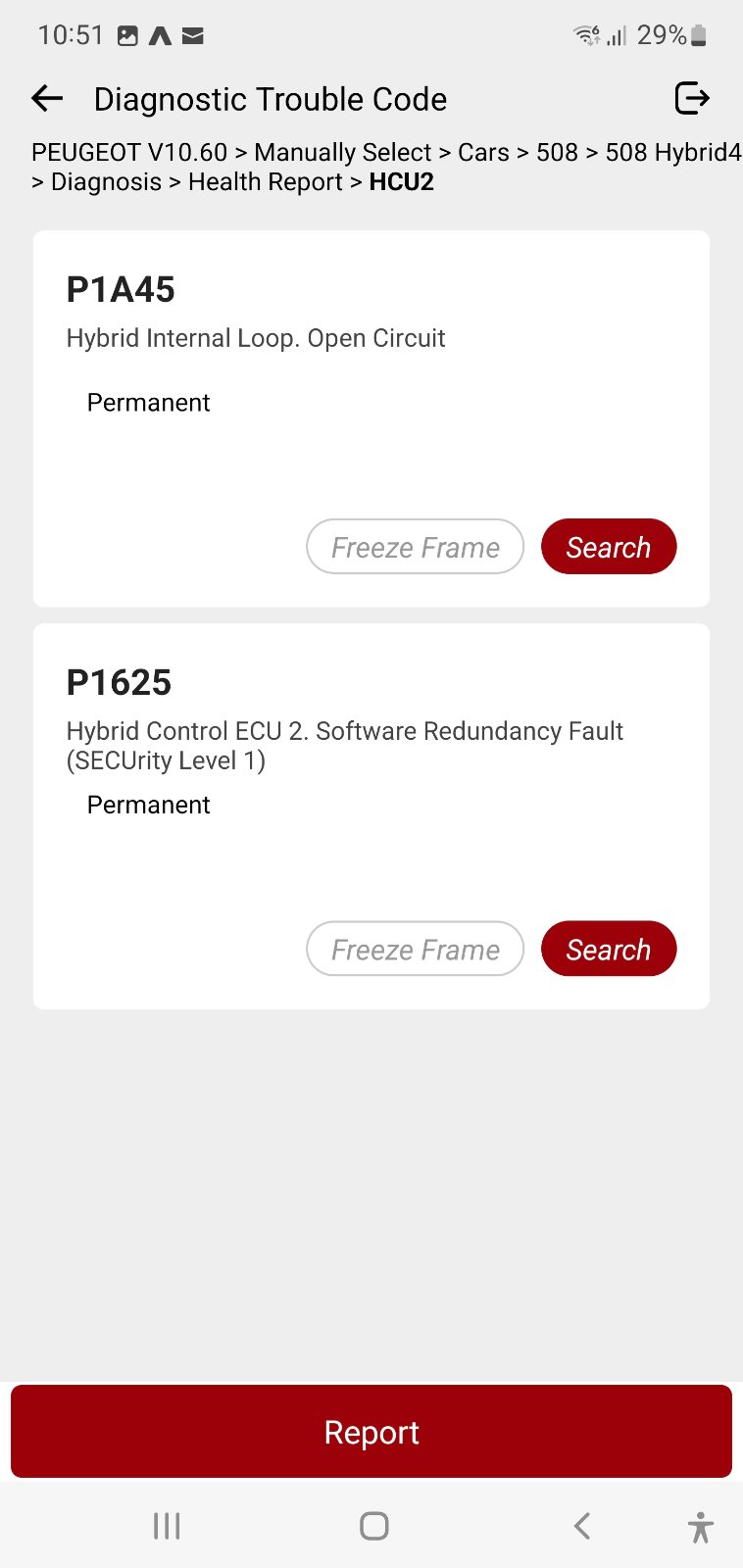

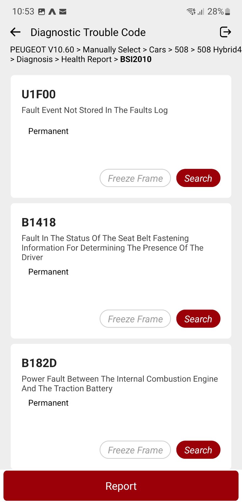

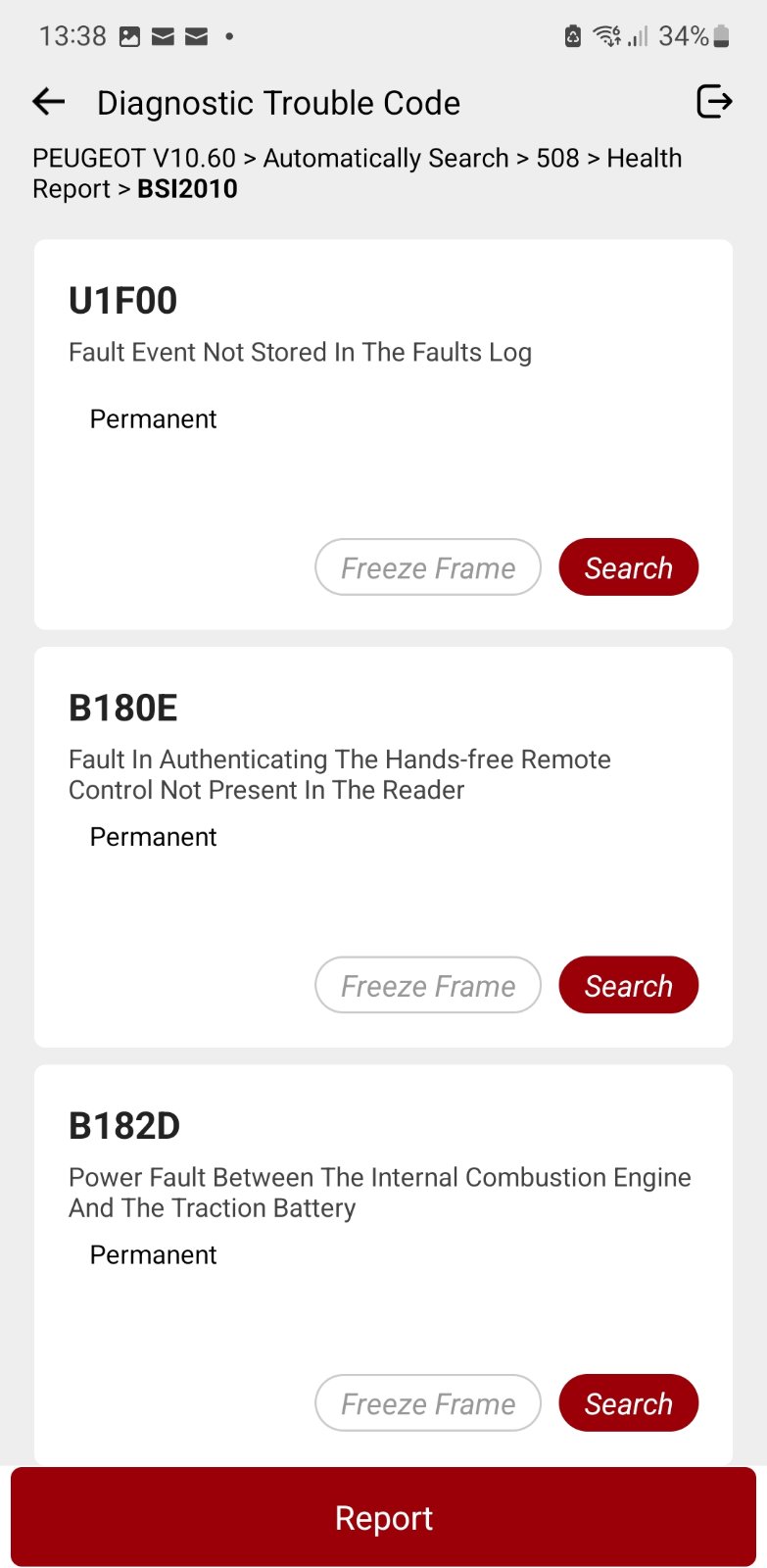

So i managed to find more codes , after I clear them the car starts for 5sec then shuts off, also after I clear th3 codes the traction battery sows full bars.

- Posts: 21343
- x 8156
Add the pics here as most members won't bother following links. Here is a guide, it is very easy.

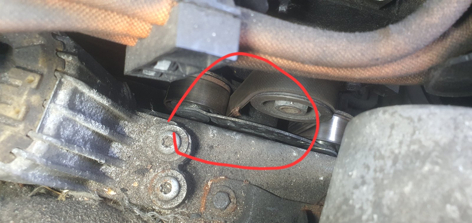

Any thoughts? I'm thinking that it might be my auxiliary belt?mickthemaverick wrote: 27 Jun 2026, 10:35 Add the pics here as most members won't bother following links. Here is a guide, it is very easy.![]()
So the Auxiliary belt isn't looking great with that stray cord as pictured, but does Nov look like it's snapped (would be unusual for it to remain so thoroughly engaged with those pulleys if essentially slack)90sPoorguy wrote: 08 Jul 2026, 14:42Any thoughts? I'm thinking that it might be my auxiliary belt?mickthemaverick wrote: 27 Jun 2026, 10:35 Add the pics here as most members won't bother following links. Here is a guide, it is very easy.![]()
viewtopic.php?p=516529#p516529
Sorry if silly question, but to confirm "won't start" how?
I.e. is it:
Turning over by starter motor but doesn't fire up,
Or
Not moving at all?
Some systems can start by starter-alternator (i.e. the alternator itself can actually as motor and start engine - via auxiliary belt) or by conventional starter motor (via flywheel ring gear)
Sorry I am not familiar enough to know what happens if one or other fails - my understanding is starter-alternator only restarting a warm engine, conventional starter rest of the time
Well if I clear all the errors the car starts for a quick 5 sec then shuts off . if I'm not mistaken my peugeot has some sort of auxiliary belt counter or time based so if it exceeds the time or the count it won't start anymore so the belt won't snap? I'm not sure on this but I read it somewhere that you also have to reset with the scantool when you change the auxiliary belt but my scanner don't have this option. but n3xt Friday my friend comes with his scanner and if I can I will reset it to se if it starts and if it does then I will know that I need to change the belt

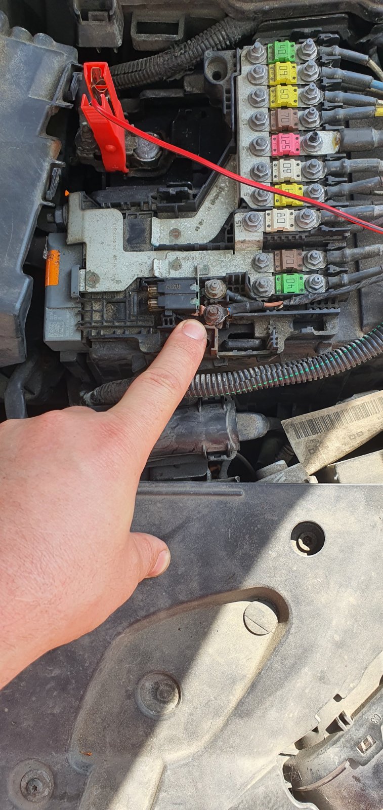

BIG UPDATE GUY'S!!
I started mesuring things on the bpga again and when I got to this fuse (that in the past was Blown and I changed it) started sparkling. I was corroded and when I wiggle it it broke so I fixed it and now I can read the traction battery ecu aswell and the engine starts and STAYS running
the car won't go into zev sport or 4x4 and when I read the codes says alternator needs programing but I can't do it because it's to hot outside so I will try in the morning or tonight and keep you posted
UPDATE!!
Managed to program the alternator and now everything works like notthing happed before
