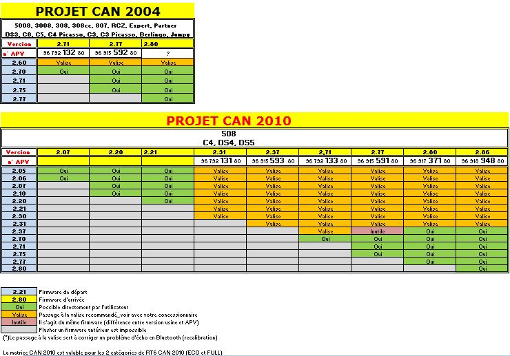

As you can see on the accompanying diagrams taking 2.05 past 2.21 means that you will lose some or all of your configuration. The official answer is to use Diagbox to connect to servers in France to download the vehicle's configuration/calibration. Mirascripts can do the same by saving the configuration before you start updating to a pen drive. There are no guarantees on this though. You do it at your own risk.
