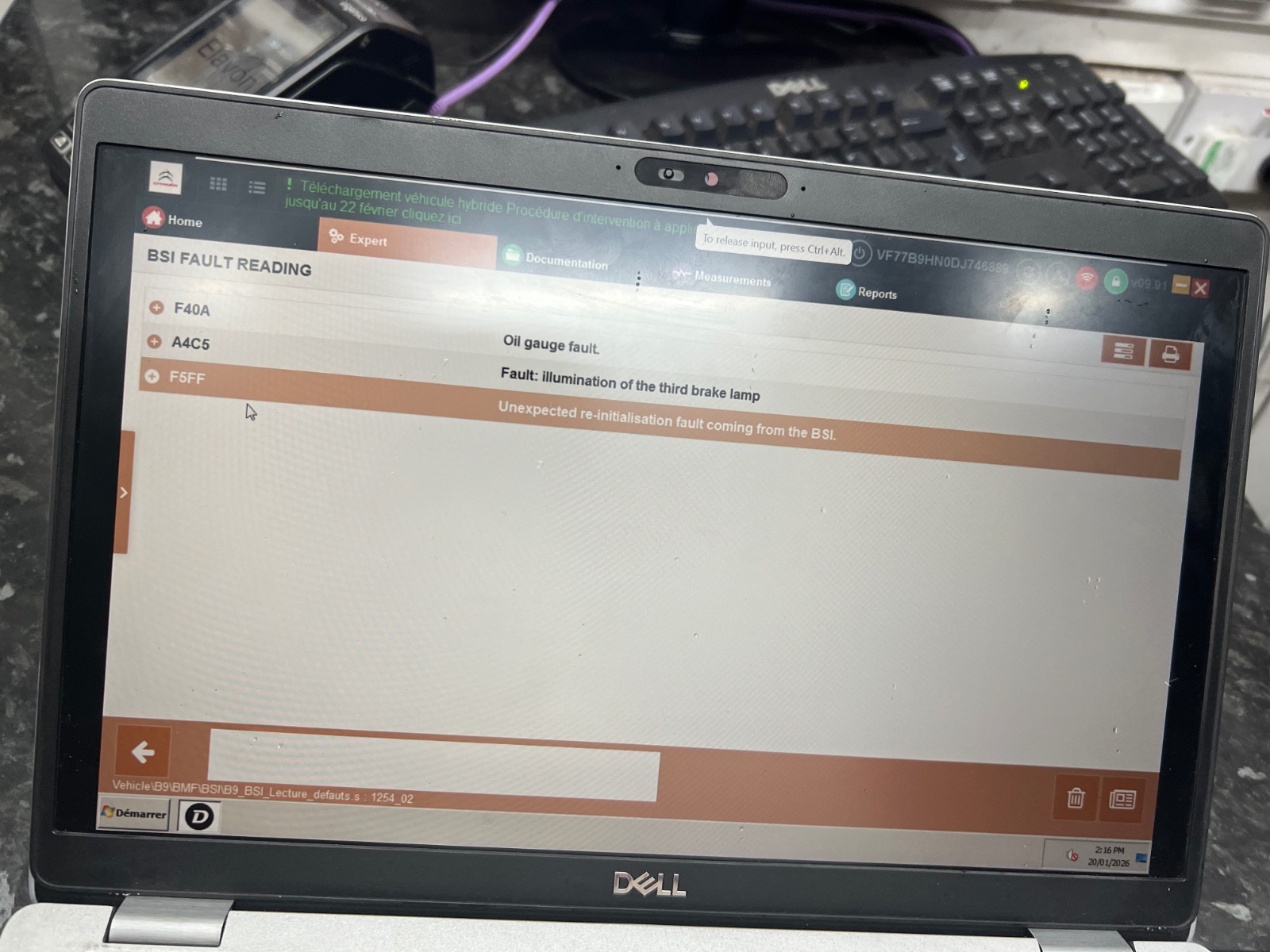

I plugged a scanner in and it shows:
• F5FF – BSI unexpected re-initialisation
• A4C5 – third brake light fault
• F40A – oil gauge fault
I’m guessing the headlight issue (maybe water ingress / bad connector / levelling motor?) could be causing the BSI to freak out and then that’s messing with the fob and horn.

Ignore the oil gauge fault, it's completely bogus.
The unexpected reinitialisation fault is probably disconnecting the battery without following Citroen's ridiculous pantomime.
Try changing the battery in the key fob. Also, the shells on these are poor quality and break frequently. If somoene has replaced that with an eBay special, the battery contacts in those can be poor.
Horn is most likely a traditional electrical fault somewhere. Same with the brake light.
Headlight sounds like the levelling motor/linkage is seized or jammed.
You have several faults - don't try and overthink it into being a single complicated one.

Look to the right of the steering wheel and down and bit. Is there a little control on the dashboard with 0 1 2 3 numbers on? Yes, you have headlight levelling. I have it on a 2011, bearing in mind they are vans and carry heavy stuff often, I'd expect it's there on most.
These are NOT major BSI/BCM type faults. If anyone pulls that, it's shorthand for "I haven't got a f**king clue about electrics, please let me go back to changing brake pads."
